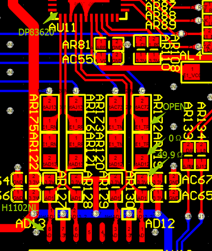

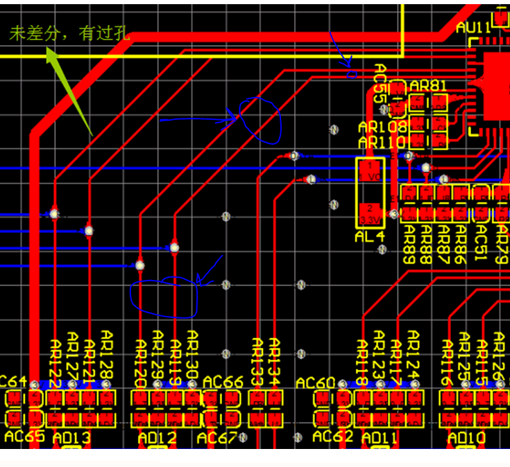

    Your schematic looks OK but your layout could be significantly improved.
    The first concern is the distance of the termination resistors/supply decoupling from the PHY.  The resistors AR127-AR130 should be close to the PHY, not so far away.
    The other concern is the differential routing.  The EI_TP & EI_TN traces have two different spacing for a significant portion of the trace, one of which is going to be incorrect for 100ohm differential impedance.
    The proper spacing needs to be calculated and used on the entire trace.

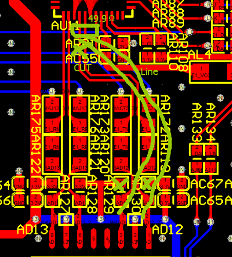

  • Hi ,
    I improved the PCB layout according to your guide, the "Eye Pattern" test pass, but duty cycle distortion test still fail. We want to know following questions:
