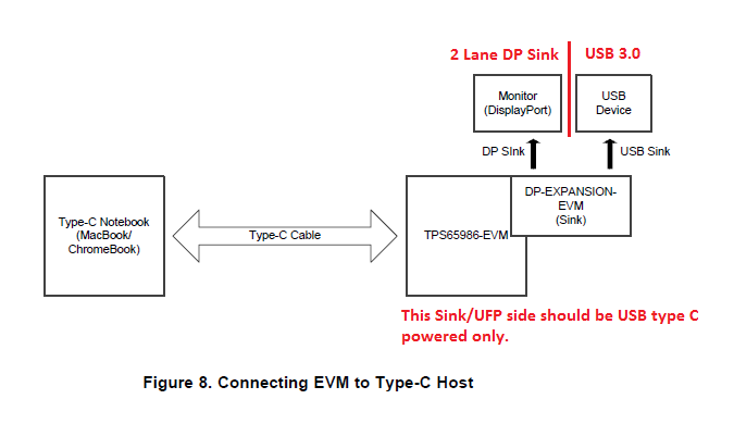

TPS65986: Confgiring TPS65986 to sink mode (USB powered only) for 2ch USB + 2ch Display port operation
Part Number: TPS65986
I am now working TPS65986EVM + DP Evaluation EVM and trying to configure this setup for device only operation to connect USB3.0 and 2 lane Display port.
Need your support in understanding how to configure TPS65986 PD controller to sink mode (USB powered only) for 2ch USB + 2ch Display port.
My testing observations with existing configuration ID's are

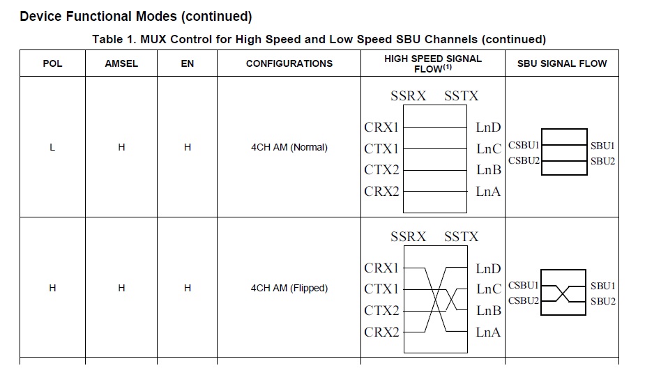

1. CFG ID- 0, 4, 5 -> USB device detected. However this setting looks like 4Lane DP mode as per MUX select lines(AMSEL->H, POL->H/L, EN->H). So I felt USB is detected in USB2.0 mode
2. CFG ID- 1, 2, 3, 6, 7 -> USB device not detected. This setting looks like 2ch USB + 2ch DP mode as per MUX select lines (AMSEL->L, POL->H/L, EN->H)
Note: The logic level of MUX select lines mentioned above are same in all listed CFG ID's.
Please help..
  • The "Multifunction Preferred" bit (in the Display Port Capabilities register) is set to 0 for all configuration IDs in the default TPS65986 booster pack firmware. The result is that 4 lane DP is always negotiated. To enable 2 lane you will must use the TPS6598X Application Customization tool to generate a new firmware image with the Multifunction Preferred bit set. Setting this bit, along with selecting "UFPD Receptacle or DFPD Plug Pin Assignment" values of C and D will allow 2 lane DP + 2 lane USB.
  • Thanks Brad for your inputs.. Can you please also clarify a doubt below relating to questions asked last time and an issue in TPS6598X Application Customization tool,
    From your points it is clear that all configuration ID's are going to support 4Lane DP so USB shall be only 2.0. However in few CFG ID's (ID - 1, 2, 3, 6, 7), the mux select lines is giving out logic levels for 2ch USB + 2ch DP mode (AMSEL->L, POL->H/L, EN->H). So in this case because of Multifucntion bit=0, the entire USB3.0(including USB2.0) is not working. Is my understanding right Brad ?

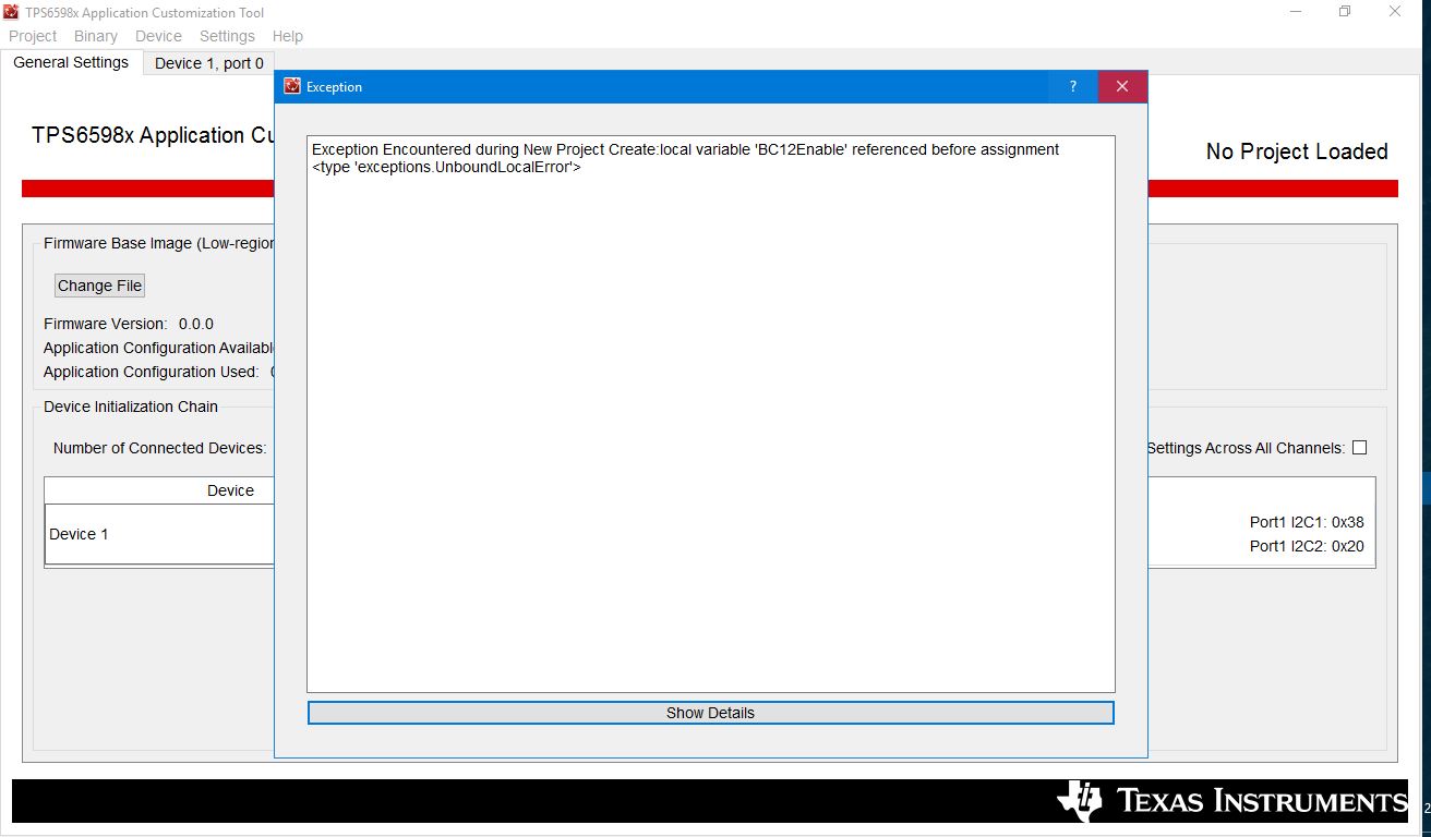

    Regarding the TPS6598X Application Customization tool usage I am seeing an exception message(as attached) pop-up on selecting TPS65986 device. Can you also help on this issue ? Only after this I can start working on generating a new firmware image with the Multi function Preferred bit set..
  • Yes, until a configuration with the multifunction preferred bit is set, USB may not work. One thing that will also help is to look at the PD negotiations to make sure that DP alternate mode is actually entered. Please use a PD analyzer to look at that.
    As for the problem loading the TPS65986 project, I have not seen that problem. What version of the tool are you using. The latest verison is 2.10. If you are using an earlier version, please download the newest version. You could also uninstall and reinstall the tool. Please install is to a directory that does not require special permissions (administrator, for example). In some instances we have seen problems with that.

    I am using TPS6598x Application Customization Tool Version 2.10 only.. I tried re-installing the tool as well but still the error persist..
    This error comes only when I select TPS65986. If I select TPS65982 the project is loading and I am able see the register settings. Please help..
  • 1. How are you opening the tempate, *.tpl, file? Are you using Project->New Project or Project->Load Project? The correct way is to use Project->New Project. I see a similar error message when I try to open it the wrong way.
    2. Please send me a copy of the templatet file you are trying to open. You can find the file in the directory:
    installation path...\TPS6598x Application Customization 2_10\tps6598x-app-customizer\gui\templates

    1. I am using below flow for loading the template file. Attached the screen shot also for your quick reference.
         Project->New Project -> Device filter (TPS65986) -> Port filter (UFP)
    2. The template file I selected is also attached herewith.
    Note: I tried selecting DFP template files also but the error still persist
    TPS65986_Application Tool Error.zip__
    Please advice..
  • Pandiya:
    Thanks for the screen shot. I did not realize that you had a newer version of the config tool. You are using 2.12, I was on 2.10. After I upgraded to the newer tool, I was able to duplicate the problem you report.
    I looked at the tool source files and believe I have found the problem. The TPS65986 template files have an error in them. Attached is the fixed version of the template you are trying to open. To use the fix, unzip the template file and store it in the directory: <installation path>....\TPS6598x Application Customization 2_12\tps6598x-app-customizer\gui\templates. Then, when you filter to look at the TPS65986 templates you will see a new template with "-fix" in the name. This is the fixed template.
    Please give it a try and let me know if it fixes the problem for you.
    TPS65986_HD3SS460_UFP_Full_2_10-fix.zip
  • Thank You Brad, the template is now loading. But I am able to see the "Multi function preferred" bit checked by default and "UFPD Receptacle or DFPD pin assignment selected with C & D by default. Attached the screenshot herewith.

    Sorry for sharing false data.. The High Speed Mux(HD3SS460) select lines(AMSEL->L, POL->H/L, EN->H) from GPIO's of TPS65986 chip is proper for 2 Lane DP + 2 Lane USB. But still the we are not seeing the DP signals.
    I have doubt on HPD between Display & TPS65986. Felt like handshaking of Type C source device & DP sink is having issue during negotiation?
    Expecting your suggestion or guidance on this. Please help..

    The DP pin assignment needs to be 'D' (instead of 'C') in order to be in 2 lanes. I am updating the test document I previously sent which will allow you to enter 2 lane DP/USB3. I will upload when complete.
    note: In order to get pin assignment D, Multifunction Preferred has to be enabled however there are some connection issues with what I suspect to be from updated graphics driver.
  • Hi Pandiya,
    I have managed to recreate your 2 lane DP issue using a Macbook as the host and a 86 EVM as the dock. It seems that the GPIOs connecting the SS MUX are incorrectly mapped in the template for this particular test case. This will be updated in the new FW release coming out soon. It will also be cleared up in the 'PD Alternate Mode: DisplayPort' or 'SLVA844A' app note - as well as any other pertinent user guides.
    Testing 2lane DP alt mode with 86 template on 2.15 FW.docx
    Attached is a step by step on how to get 2 lane DP running with one 86 EVM and a Macbook.
    Please let me know if you are able to get 2 lanes working with this setup guide.
    Thanks!
