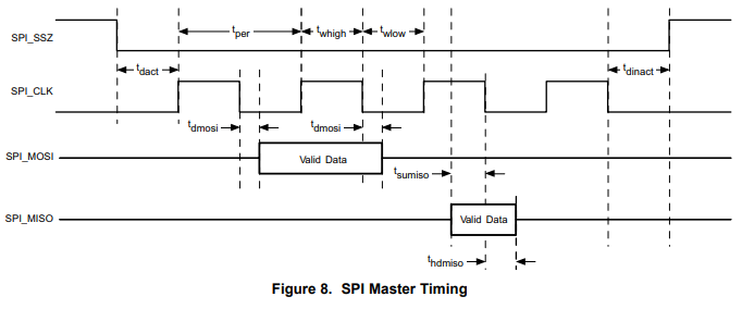

    Although another question about spi communication. In TPS65981 datasheet I have found such words:
    "The clock phase is defined such that data (on the SPI_MISO and SPI_MOSI pins) is shifted out on the falling edge of the clock (SPI_CLK pin) and data is sampled on the rising edge of the clock"
    So if I understand it correctly, data on miso must be stable during clock rising edge and must be changed during clock falling edge. But in the same datasheet I although have found this figure, where data on miso pin must be stable during clock falling edge:
    So which way is correct? May be here is my problem?
