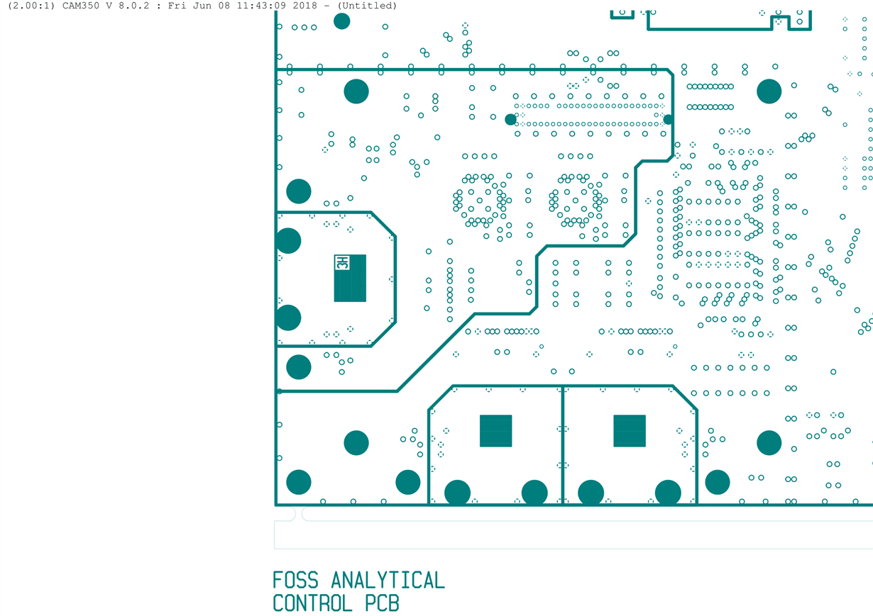

    We need to look in to circuit and layout of the board to comment on the reason for failure Kindly share the layout pictures as well.
    Geet
  • Hi
    Here you have the layout of the Ethernet part of the PCB.

    And the layers starting from layer 1 to layer 14:
    And the silk screen top and bottom:
  • Thanks for the details. I was looking thru the schematics. The chasis ground and Phy ground are isolated using 100pF caps. Can you change it to 4700 pf HV cap. Also, I am sharing link of document outlines the ESD design guidelines. Kindly review your design with the document and see if any changes needed.
