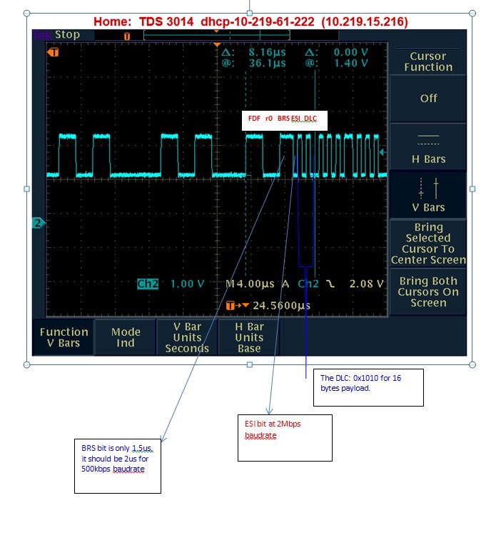

    Sorry about the delay, is there any way you can get an image of the waveforms on an oscilloscope when you send the data? There might be an issue with the CAN analyzer being able to interpret the messages.
  • Hello Eric,
    Attached please find the waveform I captured from the scope. It is traditional CAN message rather than CAN-FD message. Thanks

  • The invalid ACK bit in my test waveform was caused by the termination on CAN bus. The TCAN4550 EVM has 120ohms termination, but the CAN FD analyzer doesn't. After I added another 120 ohms termination resistor to the CAN bus, the ACK bit is OK.

    I enabled the FDF bit in CCCR and TX header, and the TBDS[2:0] bits of TXESC is 0x7 (64 bytes).
    If I use different baudrate for data, I saw the correct baudrate for both data (2mbps) and arbitration field (500kbps). The baudrate is switching at BRS bit field, and causes the BRS bit width be 1.5us (should be 2us for 500kbps), and the following ESI bit is 500ns (for 2mbps baudrate). The DLC is 0x1010 which means 16 bytes data, but only 8 bytes data are transmitted.
    The data transmitted are 0x55, 0xaa, 0x55, 0xaa, 0x55, 0xaa, 0x55, 0xaa
    I am not sure if the CRC is correct, will check. The CAN FD analyzer says there is stuff error in the frame.
