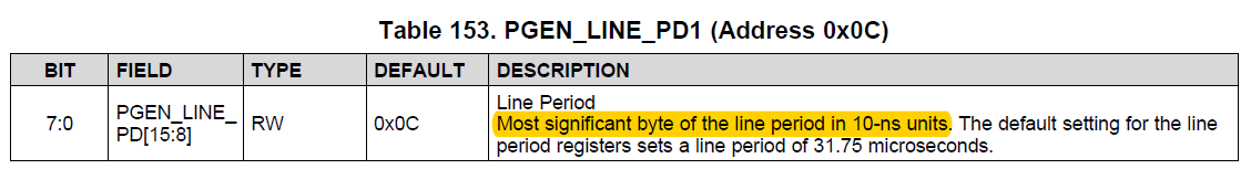

  • most are correct. but the Line_pd is incorrect.
    please see d/s on line_pd (0X0C/0X0D) description, it is calculated by: 1000000000(ns)/30(fps)/750 (lines/frame) x10 (ns/bit)= ~4444.
    best regards,
    Steven

  • Hi Steven,
    In the previous post you mention that the PGEN_LINE_PD calculation is based on the PCLK rate. However in your calculation above, and the datasheet, we just state that the line period is in 10-ns units, and don't reference the PCLK at all.
    Does this description just assume that the internal oscillator is being used, and therefore PCLK = 100 MHz (which would give us a 10-ns time base). If an external oscillator is being used, wouldn't the equation change to the following:
    IF this is the case, this description should be updated to reflect the fact that the line period is based on the PCLK, rather than assuming 10-ns.
    Thanks for the support as always!
    Andy
  • Andy,
    :( I understand your confusion.
    For UB954, the FPD-Link is fixed at ~4Gbps based on external ref. clock. So its "PCLK" is referred as 100MHz (4Gbps/40) which is used for Pattern timing calculation. In other words, this is the "10ns". BUT this "PCLK" is different from the sensor video output's PCLK.
    regards,
    Steven

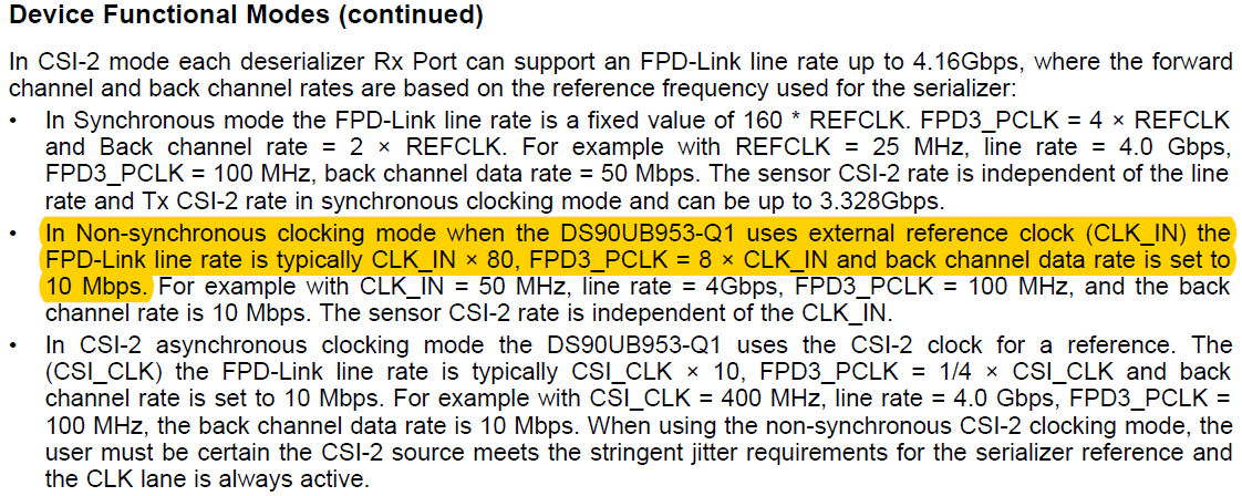

  • Hi Steven,
    Thanks for the quick response.
    Is this only true for the synchronous clocking mode? See below for a snippet from the UB954 datasheet.
    In my use case, I am doing exactly as is highlighted. The UB953 utilizes an external reference clock (CLK_IN = 42 MHz), which in turn means the line rate = 42 MHz * 80 = 3.36 Gbps.
    Would this make the pattern timing calculation utilize 84 MHz (3.36Gbps/40) instead?
    Thanks for the help!
    Andy
  • Yes, for UB953, it uses the 84MHz clock as PCLK freq. as UB953's operation freq. is based on this. so the pattern gen. timing also is dependent on this base clock.
    regards,
    Steven
