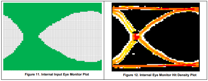

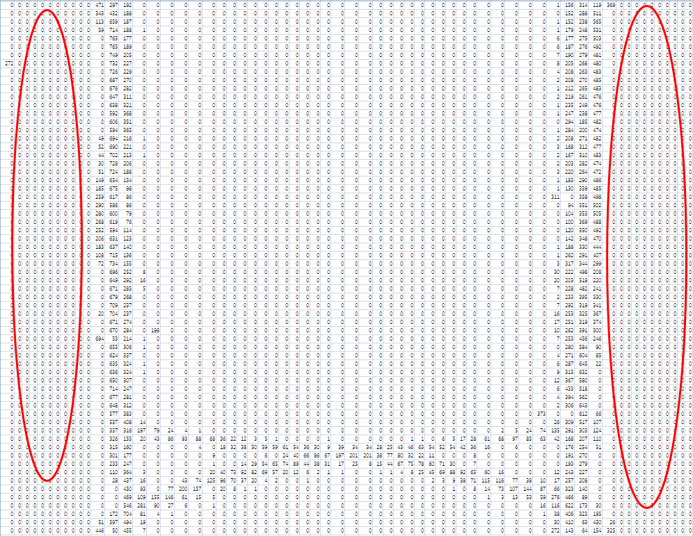

1.Is the step-by-step method correct?
2.If the setup method is correct, what is different from the data in "SigCon Architect"?
Me
SigCon Architect
3.Did "SigCon Architect" process the data specially?
4.Can you get the source code used in "SigCon Architect"?
Before Eye Opening Monitoring ..
5.Can you tell me the basic settings?
Please reply by item.
  • Hi Jinwoo,
    1). With respect to EOM capture settings, please refer to LMH1219 programming guide. LMH1219 programming guide uses read/modify write. In this operation we read the register and then make changes noted in mask settings. When reading your programming steps, I noticed a couple of inconsistency with the programming guide:
    a). spi_ti_WriteTo(0x24,0x81); I believe bit 6 is set in default mode so I was expecting 0xC1 instead of 0x81.
    b). Also, when reading 4096 cells within this loop we should wait for reg 0x24[0] = 1'b0 or this bit to be equal to zero before reading reg 0x25 & reg 0x26. I am not sure if this is done.
    2). Your result should be the same as SigconArchitect. The only difference is that in your measurement you would capture 1UI. In SigconArchitect, 1UI eye diagram is copy/pasted to the first one to show a complete eye diagram.
    3). SigconArchitect raw eye data for 1UI should be the same as what you capture.
    4). Please follow the link below and search for eye_mon_preset.txt and eye_mon_postset.txt
    C:\Program Files (x86)\Texas Instruments\SigCon Architect EVM GUI\Configurations\LMH1219\Macros
    5). Basic setting is noted in LMH1219 programming guide. Please refer to section 3.10.1.2.I believe you already have access to this document. Also, you can use section#4 above as well.
    Regards,,nasser
  • There is a figure expressed by the first derivative in the data sheet.
    Figure 11 represents the data I read,(Same information read from LMH1219)
    Figure 12 represents the first derivative.
    In my opinion, it takes special processing to make it like "SigCon Architect" data.
    A detailed explanation of the first derivative is needed.
    I would appreciate it if you could explain it using examples.
  • E2E EOM Hit Counts Capture.xlsHi Jinwoo,
    I have enclosed an Excel file with formulas so you can get eye diagram similar to figure 12 above.
    Regards,,nasser

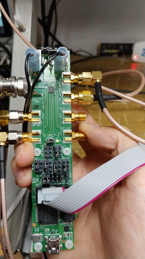

  • Thank you very much for your reply.
    I did it in the way you indicated, but I can not read the information.
    I tested with "SigCon Architect", but the results are the same.
    When set to IN1 as shown in the figure, information is displayed.
    When IN0, information is not displayed.
    I have not found the cause.
    What do you need to review?
    Also, I would like to know the CLI (Cable Length Indicator).
    What formula should I assign to Reg 0x25 [5: 0]?
    There is not enough information in the datasheet.
  •  Hi Jinwoo,
    1). For these evaluation, are you using LMH1219EVM?
    2). Please check figure 4 of the LMH1219EVM user guide. Make sure jumpers are setup like what is shown in this figure(red rectangle).
    3). Please note picture below. I used LMH1219EVM and GUI. We can clearly observe HEO and VEO value.
    Regards,,nasser
    I found a difference.
    I have tested 1080i59.94 or 525i59.94 resolutions so far.
    3G can read HEO / VEO information.
    However, SD / HD can not read information.
    Do I need to change the settings when using SD / HD resolution?
    IN1 was able to read the information without changing the setting.
  • Hi Jinwoo,
    1). Are you using LMH1219EVM for this evaluation?
    2). Please refer to the LMH1219EVM user guide to make sure you are setting up jumpers correctly. Do you have access to the LMH1219EVM user guide?
    3). Please refer to the image I sent in my earlier post. As long as you have the same settings, device should be able to lock to any rate. What are you using to generate SD/HD video?
    Regards,,,nasser
  • Each item answers your question.
    1). We are using the LMH1219EVM for this evaluation.
    2). It is set the same as the manual. (Jumper)
    I do not see any special setting method for SD / HD video input.
    3). Professional equipment (Tektronix, phabrix)
    Do you mean you have to be able to represent SD / HD without special setup?
    However, only 3G is represented normally.
    In SD / HD, HEO / VEO is not represented.
    I have not found a problem.
    Is it possible to receive SD / HD input in your environment or equipment?
  • Hi Jinwoo,
    At HD and SD HEO/VEO is disabled. HEO/VEO is operational for 3G and higher data rates. My evaluation board does not show HEO/VEO for HD and SD - the same as your board.
    Regards,,nasser
