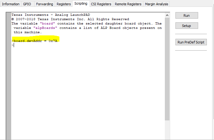

How can I change the I²C - Adress in the ALP to select the U1?

Thanks for the additional info. You can change the I2C address by going to the scripting tab and using the command board.devAddr = [device address]
