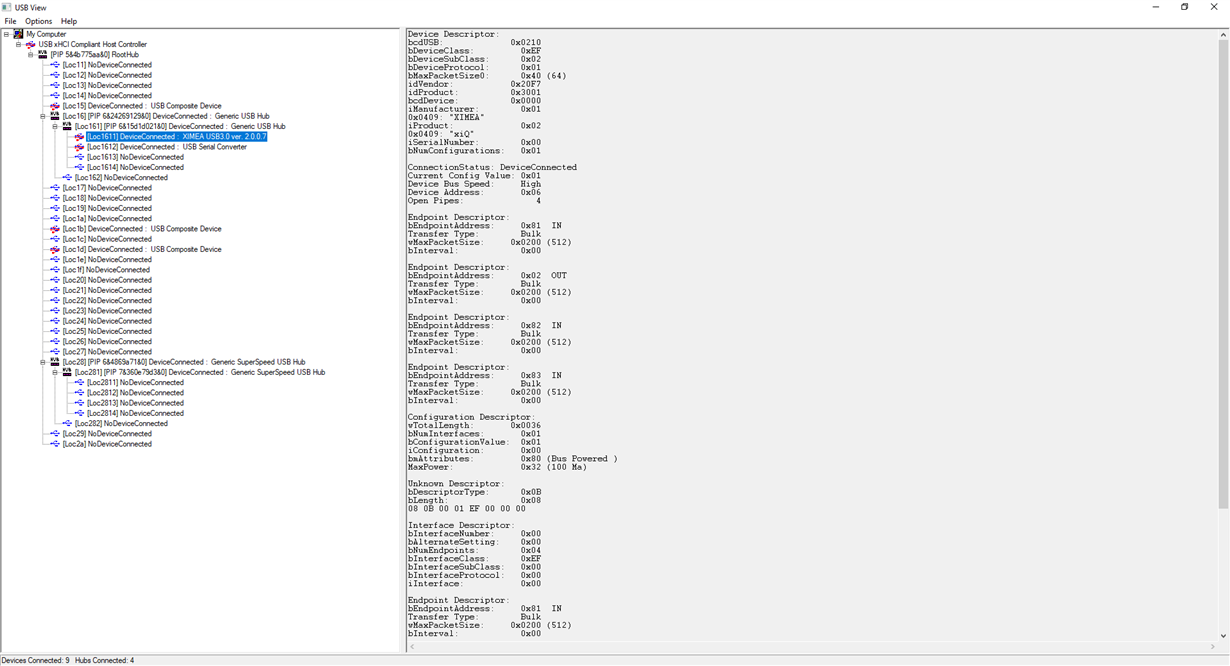

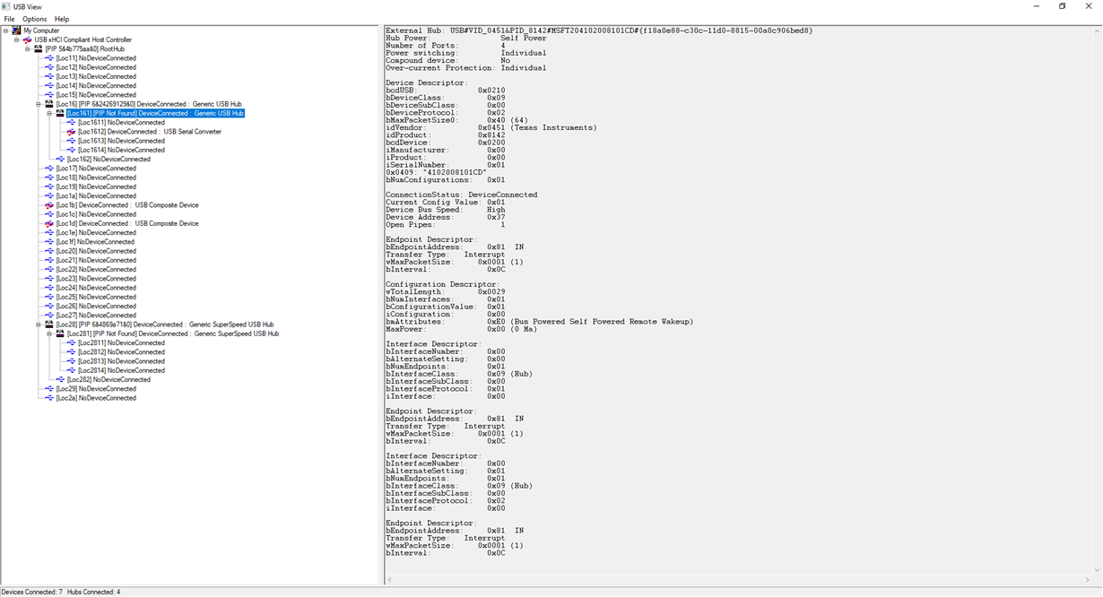

I have designed a PCB which contains a TUSB8041A USB 3.1 hub. The PCB is 6-layer with controlled impedance and intra-pair length matching for the USB lines.
The TUSB8041A  DFPs are connected to:
  1. a USB Type-C connector which connects to a USB 3.1 camera via a USB 3.1 cable, and
  2. two USB 2.0 devices contained on the PCB.
The TUSB8041A UFP is connected to a USB Type-C connector which is connected to a computer via a USB 3.1 cable.
However, the camera bandwidth is restricted to ~50MB/s which leads me to believe that the TUSB8041A is falling back onto USB 2.0 interface. Looking at the schematics, is there anything amiss?
