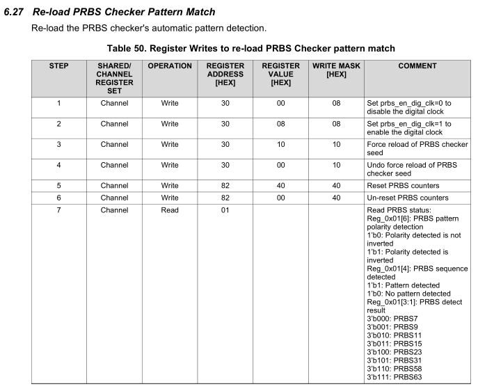

DS280DF810: Re-load the PRBS checker's automatic pattern detection.what does that mean and how does it work?
Part Number: DS280DF810
Hi e2e
I read the document that the device can reload the PRBS Checker, how does it work?
thank you.

  • Hi nasser
    The datasheet SNLS456A have the details of reg 0x30,the description of bit 4 says that "Force reload of seed into PRBS checker LFSR without holding the checker in reset."what does that mean?
    thank you
  • Hi Zhao,
    You should have access to the SNLU182C - DS280DF810 programming guide. This is part of the DS280DF810 design documents. Please register at TI.COM, use your company email address, and send me email at nasser.mohammadi@ti.com so we can provide you with access to this and other design documents.
    Additionally, we have listed register settings for enabling PRBS generator and checker as well.
    e2e.ti.com/.../701766
    Regards,,nasser
  • Hi  nasser
    I have the programming guide,but  sorry about that I don't know how to use the Re-load function,could me make the error bit counter back to zero without reset the PRBS checker,thank you.
  • Greetings Zhao,
    In earlier post, I sent you a link that describes how to set registers to reload prbs pattern. Please refer to the earlier post/link that I sent you where we describe to how to reload PRBS pattern.
    Regards,,nasser
