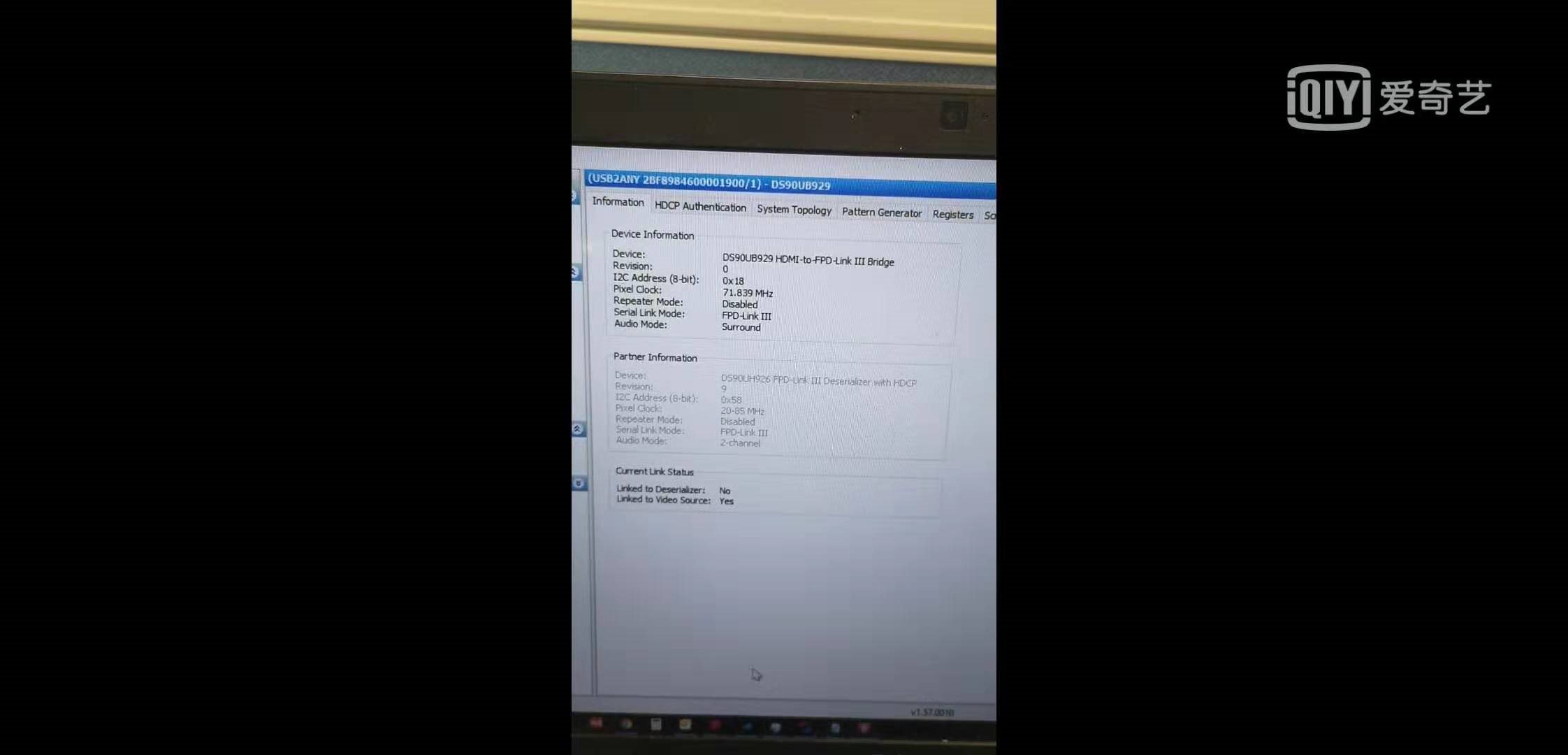

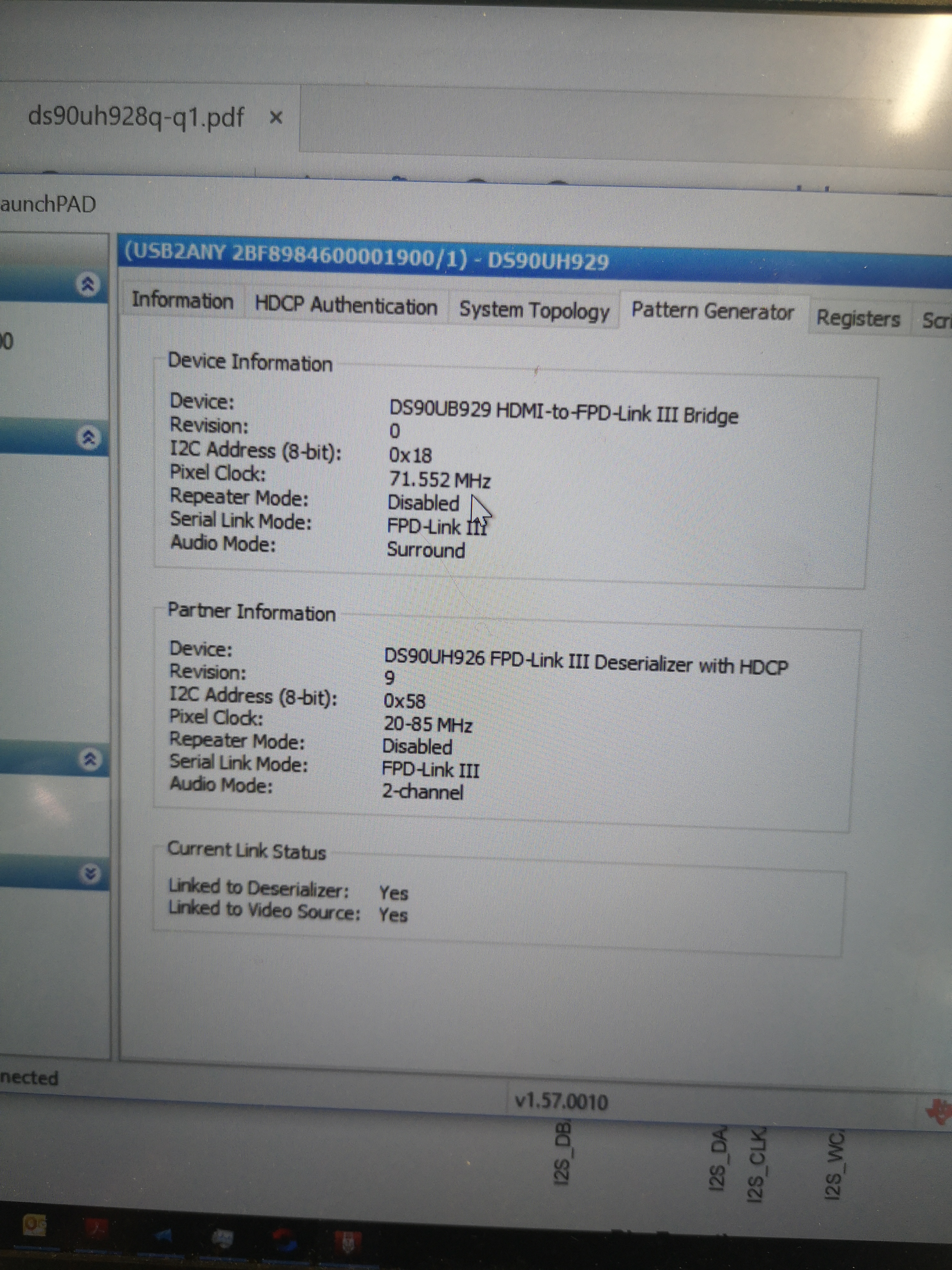

Background: After the high temperature test on DS90UH928 system, when connect 929 with 928 , use the same 929 connected with different 928, found some 928 can communicate with 929 through I2C, but some 928 can't (The problem was found in four of the more than a dozen films) .
Relate test:
#1 No matter in the case of I2C normal communication or abnormal communication, video signal can be transmitted normally
#2 ABA test,Remove the 928 chip that cannot normally communicate with the 929 and put it on the 928 system board that can normally communicate, and the phenomenon will follow the 928 chip that cannot normally communicate
#3 Put the 928 chip that cannot normally communicate with 929 to our demo board, then it can communicate with 929 normally, and the register value as attached file shows.
#4 Test the power ripple, it looks good.
#5 remove all the I2C that connected with 929 and 928 on customer system, still can't build the communication
#6 Under the condition of no connection to 929, power is supplied to the system board of customer 928 separately. By comparing the registers of 928 which can normally communicate with those of 928 which cannot, it is found that the values of the following registers are different, as shown in the pink part.
Conclusion: By compare the test result of #3 and #6, it seems that the only difference is the 0xF2 register. when it can't work normally, the 0xF2 value is 0x42, which means ID code "B", when it can work normally the 0xF2 value is 0x48, Which means ID code"H".
Question: Could you please kindly help to give some suggestions about this issue. I also attached customer's SCH  for reference. Really appreciate for your time and looking forward to your reply. Thank you !

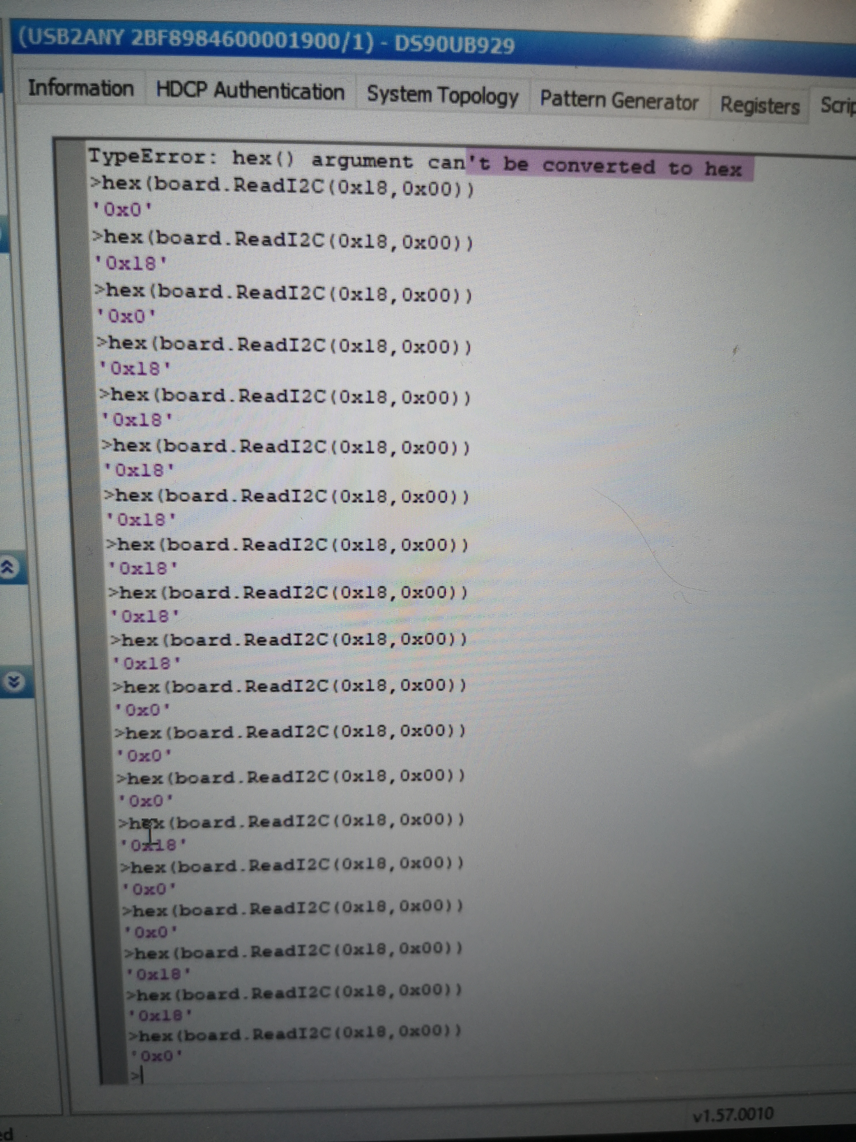

  • Could you provide the 929 register reads? Do you see any CRC errors on 929 register 0x0A and 0x0B?
  • Hi Charley,
    Thank you very much for your quickly reply.
    When 929 connected with 928, we found that 929 register is unstable, as the first picture shows, you can see that  when i read 929 for many times during the abnormal communication, the value in 0x18 will changed. Another side in the second and third picture, we can see that the DES was missed recognized, and sometimes 929 can't recognize DES at all. The fourth picture shows the 0x0A register compare between good condition and bad condition. i also attache the relate test file, thank you very much and appreciate for your patience.

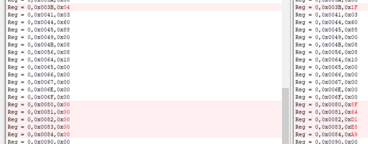

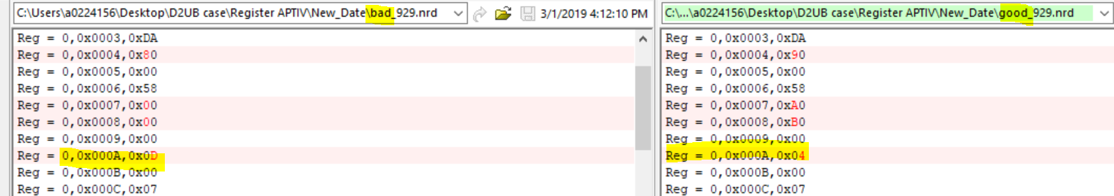

  • Do you have any other devices on the same I2C bus? If yes, would you able to disable other I2C devices to isolate the bus.
    On the 929, why are registers 0x04, 0x0E, 0x17, 0x19 and 0x1A have different values between good and bad? Did you change the value?
    On bad system, could you change the registers to match the good system and see if you could talk across the channel?
    Charley Cai
  • Hi Charley,
    Thank you very much for your reply.
    Yes, we also tried to disconnect all the I2C bus device both on 929 side and 928 side. I2C still can't work.
    we do not change any register of 929. From last reply i send to you we can see that 929's register is unstable after connected with 928.
    For 928 difference we can't change the different register cause these different registers are read only.
    So far i think it mostly relate to the 928 0xF2 register after power up. Cause after we have the same power supply condition only for 928 systerm(not connected with 929 systerm), and we do not make any configuration about the 928 device, but the register of 0xF2 is different, abnormal one is 0x42(ID code means"B"), but normal one is 0x48(ID code means "H"), so i mean if there have some design limited for different UH928 devices.
