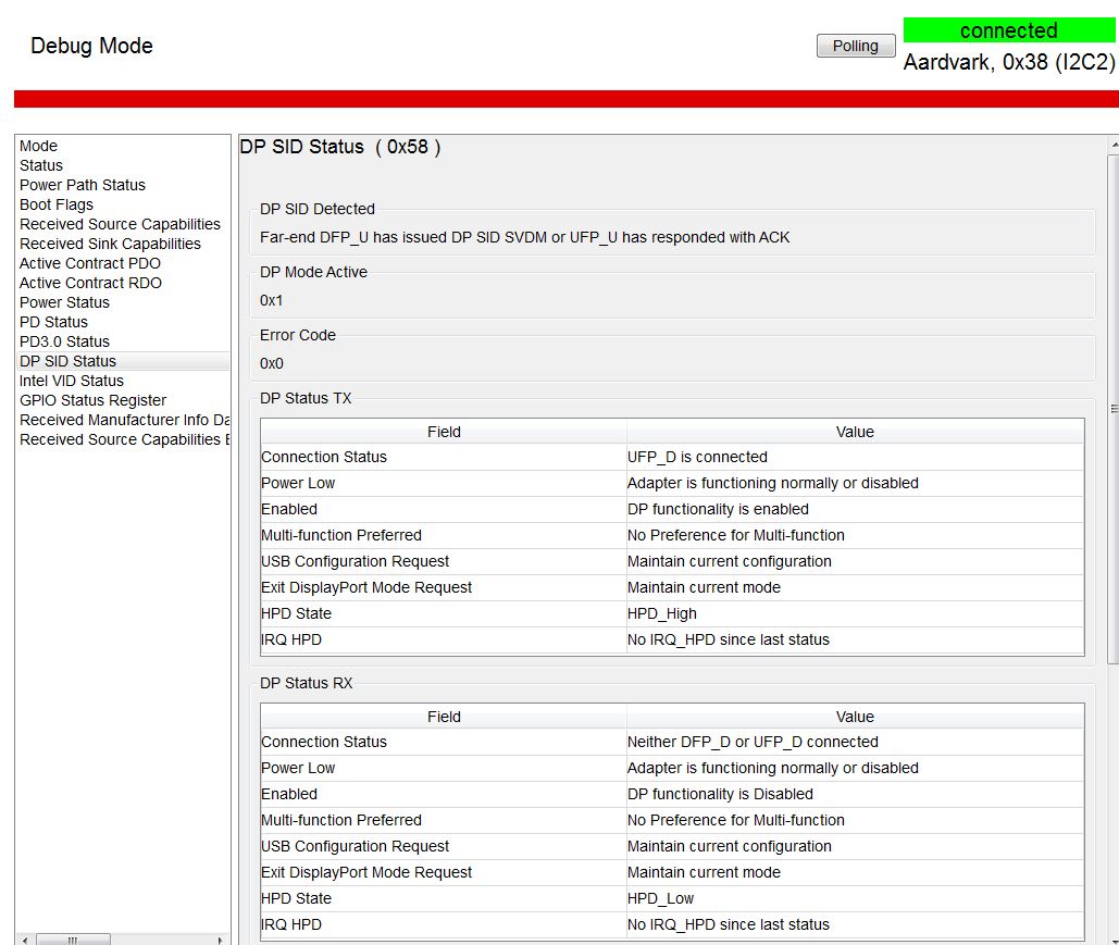

  • Hello Eric,
    I did ask similar question by showing you terminal read back from register 0x58.
    Now, I do have Aardvark adapter connected to my computer, and I can communicate from Application Customization Tool directly to our board.
    And here is the 0x58 register:
    For some reason DP status RX looks incorrect.

  • Hi Aleksey,
    Since you are designing a DP UFP, I would only check DP Status TX. The DP Status RX fields would be populated in the DP_DFP. Again, I don't believe this is an issue with the TPS65987D.
    Can you reproduce this issue on the TPS65987EVM with the 10G-EXPANSION-EVM?
    Eric
