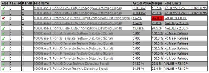

We have 1000 Base-T eye pattern test fail on DP83867I, did you have any idea or any experience can share?
Is there any adjustment setting?
Report as attachment
100_1000Base-T.ZIP

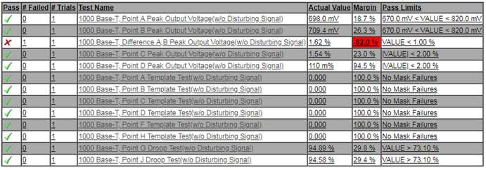

Currently pairA, pairB FAIL, pairC, pairD PASS
Pair A
Pair B

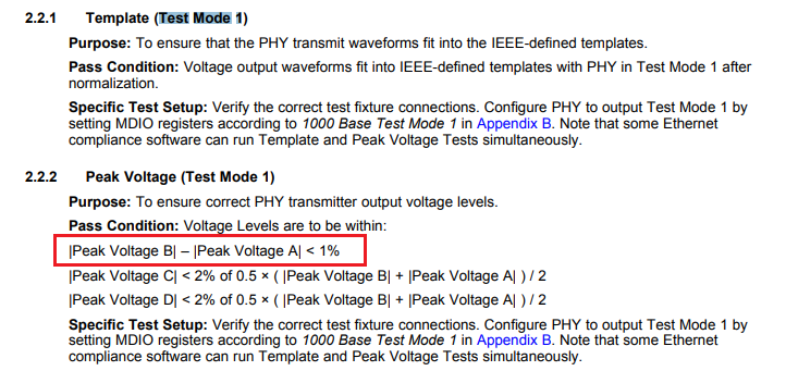

  • Hi Shu-Cheng,
    These minor failures are usually caused by board layout. Please follow this app note for layout guidelines: http://www.ti.com/lit/an/snla079d/snla079d.pdf

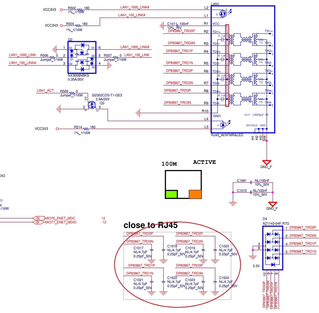

  • Hi Sirs,
    Thanks for your reply.
    Could you help to check our layout and schematic as below.
    Schematic:
    Layout:
    Have any suggestion can share?
    Because we have the same problem with two models
    By the way, the place of MDI looks good!
  • Hi Shu-Cheng,
    1. Are MDI pairs laid out as 100-Ohm differential?
    2. Do you have compliance result for 100Base-TX on both pair A and B?
    3. Can you remove the ESD protection device and redo the measurement for 1000Base-T?
    4. For MDI connection, each center tap of the magnetics should be independently de-coupled to ground via a 0.1uF capacitor. See this app note http://www.ti.com/lit/an/snla246a/snla246a.pdf for more details.

  • Hi Sirs,
     Update as below
    1. Are MDI pairs laid out as 100-Ohm differential?   YES  100-Ohm differential
    2. Do you have compliance result for 100Base-TX on both pair A and B?   YES  , Please refer as below
    100_Base-T.zip
    3. Can you remove the ESD protection device and redo the measurement for 1000Base-T? Yes, Still fail
    4. For MDI connection, each center tap of the magnetics should be independently de-coupled to ground via a 0.1uF capacitor. See this app note http://www.ti.com/lit/an/snla246a/snla246a.pdf for more details. Yes,
    - Your schematic shows 0.25pF cap on each MDI pin. Make sure those caps are not populated.
    - The center taps of 4 channels are connected together inside the MagJack. It is not recommended for this device. See app note http://www.ti.com/lit/an/snla246a/snla246a.pdf
    Hung Nguyen
  • Hi Sirs,,
    1. The 0.25pF cap is reserved, not populated.
    2. We'll discuss with MagJack vender to check this question.
    Actually we would like to use EVM to verification, but we not sure EVM will pass this report.
    So, does TI have this test report can share?
    Thanks!!

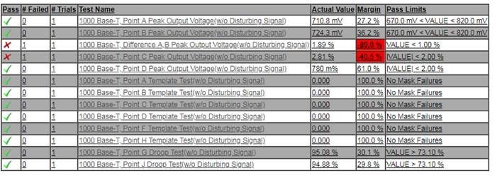

  • Hi Sirs,
    Update our test result.
    2. We used another MB to test and change the RJ45 Connector that was not connected inside the center tap.
    The phenomenon is still same as before, the report as below
    change conn_ESE0273082.zip
    Any suggestion are welcome. Thanks!!

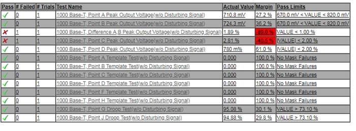

    Our fail items on report as below
  • Hi Shu-Cheng,
    It's interesting that when you change the MagJack, the failing channels changed from A,B to B and D. I'm wondering whether other 1000Base-T tests passed or failed.
    1. Can you provide other 1000Base-T test results (including return loss) for all channels?
    2. Can you remove the last 4 register writes to see if there is any difference?

  • Hi Sirs,
    For now we found oscilloscope formula if update to new version, the test will be passed.
    I'll to close this topic,
    Thanks for your help.
