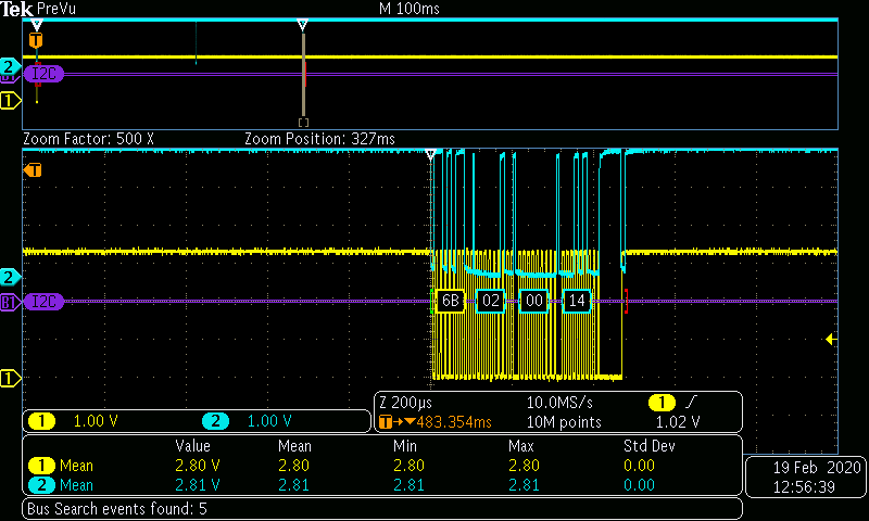

At dead battery power up, I monitored the I2C bus between the TPS65987 and the BQ and I found that several I2C commands from the TPS were getting truncated.  The register addresses and data were not present in the messages.  These are the initial commands sent out as discussed in SLVAE-18. See the scope capture.  None of the data elements are transmitted after the 0x6B address.
And then the first command that actually is sent correctly is some 300ms late setting the charging current:
Thus leaving the watch dog timer set and causing our system to stop charging.  At approximately 175 seconds, the battery would stop charging.  This behavior occurs on both the EVM setup and our system.  The truncated messages are also the same.  The above SLVAE-18 messages transmit correctly if we plug in a not-dead battery to a system (no USB-C power).

  • I missed the fact that it looks like those "truncated" transmissions do in fact have no ACK from the BQ.  I will look further into how the BQ part gets powered in dead battery mode that may cause it to miss the initial transmissions.
  • Hi David,
    Yes that was going to be my suggestion. The PD controller is sending a command to the charger once it powers up, but the battery charger is not powered on yet and NAK's the commands the PD controller is trying to send. I would double check with the charger team, but during a dead battery event, the battery charger will be powered from the VBUS pin. Assuming the trigger event is on power reset, you can also send these commands again once the PD controller closes the power path to the charger, supplying voltage to the VBUS pin on the BQ.
    Hope this helps solve your problem

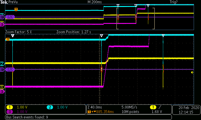

    I performed additional testing using the EVM boards.   As we suspected the BQ part does not appear to be powered on soon enough.  In the capture below: Blue=SDA, Yellow=SCL, maroon=Vbus from PP1
    As you suggested, I tried duplicating the POR I2C master events using "PP1 Switch On (closed)" as the trigger event.  So now I have 4 POR events (far left SDA/SCL activity), and an additional 4 events in the I2C traces (middle I2C activity).  PP1 switch is closed (on) when my USB-C is connected in dead battery mode (used debug mode in the App GUI tool to verify).  Note the maroon trace, it is the VBUS feed from the TPS to the BQ.  Note it doesn't began ramping up to 5V until ~17ms after the new PP1 closed I2C events.
    It looks like the only event (right side SDA/SCL activity) that is successful is the PDO sink contract that gets negotiated some 300ms after the POR events.
    Based on the above, it looks like the BQ part really won't be active until well after the POR events and even PP1 closed event.
    I do have "CHRG_OK" wired to a GPIO on the TPS and I could use that possibly as an I2C event trigger, but it is not clear to me how to do that as I don't see any trigger event pull down selections mentioning GPIO.
    The work around I am leaning to right now is to resend any critical configurations on PDO Sink negotiation.  For me these are the charge current set, no watchdog, and the correct charge voltage level.
