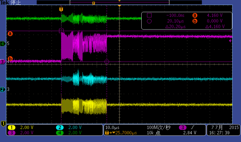

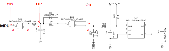

Our customer had designed Power On Reset circuit (when startup and once OUT is high, it will outputs continuously high.) with two NAND logic.
But, the circuit did not worked well , the output had oscillated, as figure I attached.
Then, the customer found that R34(1Kohm) had removed and the oscillation has stopped.
If possible, please tell us why the first customer's cirucuit had not worked good
and is there any issue with this usage(LVC00 with R34 removed) ?
Or please show us your recommended circuit example.

When slow inputs are used, a part with Schmitt-trigger input circuitry is the best solution to avoid this type of problem. The SN74HC132 would be a better solution for this situation.
If you are interested to know exactly why these oscillations occur, please refer to our application report, "Implications of Slow or Floating CMOS Inputs."
