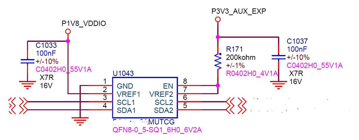

  • Customer has another question:
    I have another question related to LSF010x  isolation buffer.
     There is an application where if the VREF_B is tied to 3.3Vaux (standby power), but Vref_A is 1.8V (main). When the system is OFF. So the Vref_A is 0V, but Vref_B is still 3.3V.
    We see there is leakage to Vref_A which is on 1.8V rail.
    Is this expected behavior?
  • Please provide a schematic.
    How was this leakage measured?
  • The leakage was measured by probing at U1043 pin2 VREF1 when system is power off where P3V3_AUX_EXP is still 3.3V. P1V8_VDDIO is supposed to be 0V.
  • Hey Ronnie,
    I assume there are pull-up resistors for both sides of the SDA and SCL lines that are not visible - because it won't work without those.
    The reason you're seeing leakage to the VREF1 pin is because that's how the device is designed -- when VREF2 & EN > VREF1 + 0.5V, then the bias circuit conducts. There's a video that shows exactly how this works here: Understanding the Bias Circuit for the LSF Family
    If you want to shut off the device, I have a video that discusses exactly how to do that here: Using the Enable Pin with the LSF Family
    It looks like you're using a PCA9306 - which does work exactly like the LSF010x family. I'm just curious, why didn't you include that part number in the post? That device is actually handled by a different team (I2C), which is why I'm asking. I certainly don't mind helping, but I find it odd to mislead us on this.
