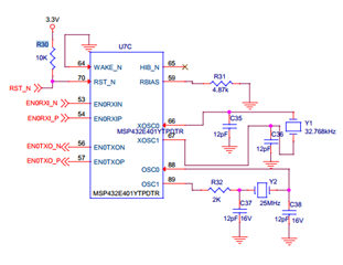

PCB JTAG Schematic details:
Help me to resolve the issue.

  • Hi Kalyan,
    Could you help to share your hardware connection for your board? And sch?

  • Hello Josh,
    Kindly go through the setup and the schematic.
     Test Setup:
    PCB:
    Thank you.
    Kalyan.
  • Hi Kalyan,
    I looked your schematic, I think there should OK.

  • Hello Johnson,
    Looks stranger
    Initially on the board,
    3rd pin of Y1,
    2nd pin of Y2 to C38, 3rd & 4th pin of Y2 are NC.
    later using jumpers, I connected 3rd pin of Y1 to Gnd, 2nd & 4th pins of Y2 to Gnd and
    3rd pin of Y2 to c38. You could see that on the pcb pic.

  • Hi Kaylan,
    I checkd the crystal of E401 Lanuchpad, the #1 and #3 is the IN and OUT.
