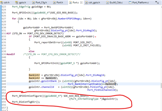

  • Hi Kowshik,
    In the picture below you see the enabled Set is on 0x00004000. It must be 0x00010000, right?
    best regards

  • Hi
    Can I know why are you seeing VIM registers are variables view? have you written any code to read the VIM Regs and print them?
    However I think that is fine, is it possible we can debug  this over a call? Please let me know your free time and propose a slot so that we can get on live debug session to resolve this.
    The example code I was testing is the GptApp.c example from the MCAL folder

  • Hi Kowshik,
    The Problem is solved. The port configuration was a different (see code below).
    .Port_PinId = PORT_PINID_IRQ_BUTTON,
          .Port_PullInhibitEnable = PORT_PIN_PULL_INHIBIT_DEFAULT,
          .Port_OutputOverride_Ctrl = 1,
          .Port_InputOverride_Ctrl = 1,
          .Port_DirectionChangeable = FALSE,
          .Port_PinModeChangeable = TRUE,
          .Port_PinLevelValue = PORT_PIN_LEVEL_HIGH,
          .Port_PinDirection = PORT_PIN_IN,
          .Port_PinInitialMode =  PORT_PIN_MODE_GPIOAB,
          .Port_PullTypeSelect = PORT_PIN_PULLTYPE_DEFAULT,
          .Port_SlewControl = PORT_PIN_SLEWCONTROL_DEFAULT,
          .Port_NumPortModes = 1,
          .Port_PinMode =
          {            [0] =
                 .mode = PORT_PIN_MODE_GPIOAB,
                 .muxmode = 7,
          .Port_PinDioRegId = 0, /* GPIO register index is 0 based */
          .Port_PinDioChannelId = PORT_PINID_IRQ_BUTTON,
          .Port_RegOffsetAddr = PINB8_LIN2_RXD,
          .Port_PinSignalName = (const sint8 *)"GPIOAB_21",
          .Port_PinName        = (const sint8 *)"PIN_B8",
          .Port_PinSetEdgeTrigger = TRUE,
          .Port_PinSelectEdgeTrigger = PORT_RISING_EDGE,
