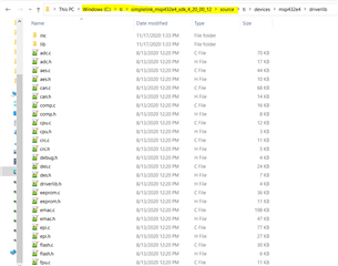

I imported gpio_bothedge_interrupt from the Resource Explorer and was able to run that code in the imported c file.  However, when I simply copy that code and paste into another main.c file in another project, I get the error: "cannot open source file "ti/devices/msp432e4/driverlib/driverlib.h".  Where is this header file hidden and how can link or point to it in another project that isnt imported?
      In the imported project it has the below directory for the include path that you most likely didn't have in your other project. See below.
    If you go to C:\ti\simplelink_msp432e4_sdk_4_20_00_12\source\ti\devices\msp432e4\driverlib you will find all the driver files.
    I think in CCS you might want to also do a refresh if you update some system variables.
