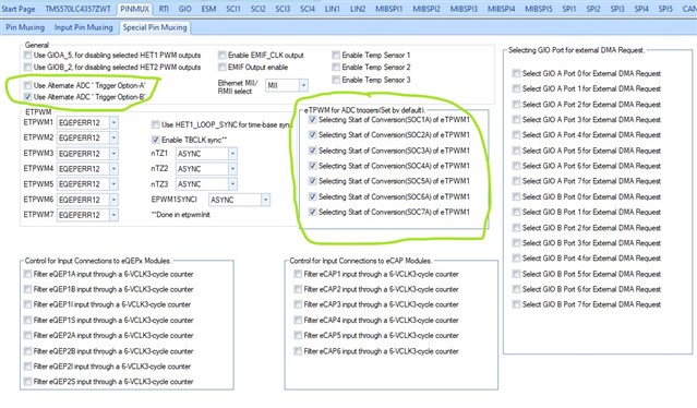

  • Hi Jagadish,
    Thank you for your reply.
    Actually I got value on adc_data[0].value whic is convert analog voltage from Potentiometer and I confirm its correct value.
    Then adc_data[1].value(ADC pin 10)& adc_data[2].value(ADC pin 11) which are connected to current sense, it has the same value with adc_data[0].value.
    Please kindly check the pwm setting on picture below. I did enable the ADC SOCA. On the Pin Muxing also I saw by default it selecting start of SOC of eTPWM. Please kindly advice, is there any setting or register I need to take a look so that adc_data[1].value(ADC pin 10)& adc_data[2].value(ADC pin 11) can get correct value from current sense? Or since I use Hardware trigger, should I connect  eTPWM pin to the Adc pin with wire or doesn't need?
    Thank you.
    Lukman

  • Hi Jagadish,
    I want to update that I solved my issue. Some how after I change my flash setting from necessary sector only to entire flash, everything is working nicely.
    I appreciate your help.
    Thank you.
