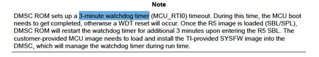

TRM chapter 4.2.3 lists the below watchdog timer related information. From the last sentence, it mentioned SYSFW image needs to be loaded to DMSC, and it will manage the watchdog timer during run time. A few question regarding this sentence:
1) For this watchdog timer maintained by SYSFW, is it still present after R5F core runs its appimage?
2) If this SYSFW's watchdog is still active during appimage's runtime, which WDT timer is used here? And what is the expiration time?   Who is patting the watchdog? And when it fires a watch dog reset, what is the behavior?

    1) This watchdog is petted by SYSFW image running on DMSC as long as the firmware is running.
    2a) MCU_WDT0 is used by DMSC SYSFW image.
    2b) Within the OSAL the watchdog is serviced in the following locations:
    1. A call to rti_wdt_pet happens in the OSAL idle thread. This ensures that the system does not experience a watchdog reset when no messages are being serviced. The idle thread will not execute if a task gets stuck as the idle thread only executes when no other is executing; if any thread is hung, it will block the idle thread and prevent servicing of the watchdog from here.
    2. A call to rti_wdt_pet happens at the end of each OSAL message processing task. This ensures that if a large number of messages come through the system equal to or faster than the rate at which they are processed the system does not experience a watchdog reset due to the idle thread being unable to run.
    2c) The expiration time is configured by ROM for 180 seconds. Not modified by SYSFW.
    2d) When WDT fires a reset, a DMSC Cold Reset (Device Level PORz Reset) is asserted.

    Based on your explanation, if SBL successfully loads the SYSFW, but it fails to load the appimage to r5f core:  since DMSC is still running and petting the watchdog, it would not cause reset to let SBL to retry to load appimage, right?  In other words, my question is: does the DMSC WDT reset the MCU when SBL fails to load/run the appimage?

    I know we've discussed this during our sync, but wanted to close here. As long as the DMSC RBL has been successfully loaded, the DMSC WDT will continue to be pet even if SBL load fails and thus will not issue a reset.
