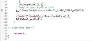

  • Hi Jagadish,
    I used the CAN_Boot_Loader example to get the jump to the application function.
    UART_putString(UART, "\r Jump to application... ");
    g_ulTransferAddress = (uint32_t)APP_START_ADDRESS;
    ((void (*)(void))g_ulTransferAddress)();
    This is the function that I used. But I could not jump to the application. Is there anything other do I need to perform?
  • Hi Jagadish,
    One update from my side i am able to jump to application code but not working anything in application.
    i have used the bootloader code whichever you have shared CAN Bootloader.
    Now i have replicated same in my bootloader code too and it is jumping to the application code.
    Is there anything i am missing in startup file to add in the startup fille i am using whatever is there in LED blinky code.
    In application i am blinking LED and it is not working please check on that part .
    Is there i have to change in startup of linker file which i have shared.

  • Hi Jagadish,
    First i have some queries ,
    1. What is the vector address for your application and Bootloader?
    2. Why the Application start address is 0x20020 why not 0x20000?
    3. I have did the same steps whatever you are doing so i am getting
    now i will give you the steps whatever i have performed..
    1- i have built with the application code with below linker file.
    After that i have tried the flashing the application code through uniflash with below settings.
    the erase setting for this now
    after that i have flashed it and i can see the symbols in the memory sectors.
    after that i have flashed the bootloader code with
    and the flag whatever is there that i have bypassed and directly jumped to the application.
    and the start address of application is.
    for just reference i am blinking the LED in bootloader also and Application also
    So in bootloader LED is blinking but once it jumped to application then it is not working.
    This are the steps whatever you have shared..
    After that one changes from my side too for other way of flashing using INCA tool for TMS570LS1224.
    if i flashed the code using INCA tool it is flashing but i am not able to see any changes in the low level registers for GPIO pin and other peripherals.
    Only here i can see the Interrupt is working and code flow is also i am able to see using CCS by connecting target configurations.
    Here are some queries - Is there any way that the controller will goes in lock after flashing through INCA tool.
    - OR one thing is that i am using same Startup file in bootloader and application also
    So is there any changes in both startup file or is controller is going to the privileged mode and not allowing to modify the registers.
     Thanks and Regards,
    Shriram Madhavai

  • Hi Jagadish,
    The application is jump from bootloader to application and it is not working previously but after changing the clock function MapClock() in system.c file it starts working and flashing correctly.
    Thanks and Regards,
    Shriram Madhavai
