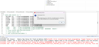

       But enable the mpu often cause the code run away into the invects table-DataEntry. I try to resolve this problem some time,and then  cause a new problem that I cannot debug the code,the ccs error as below picture:
        the detial discribe as below:
        CortexR5: GEL Output: Memory Map Setup for Flash @ Address 0x0CortexR5: Error initializing flash programming: Target failed to read 0xFFFFFFF0
        CortexR5: Loader: One or more sections of your program falls into a memory region that is not writable. These regions will not actually be written to the        target. Check your linker configuration and/or memory map.
        CortexR5: File Loader: Verification failed: Values at address 0x00000000 do not match Please verify target memory and memory map.
        CortexR5: GEL: File: C:\Users\hjb\Desktop\Test_TMS570LC_OS1008\FLASH\Test_TMS570LC_OS.out: a data verification error occurred, file load failed.
        I try to restart CCS、PC、Development Board,and reconnect the xds100v2, but still unable to solve it. Can you tell me what the reason is?please!

  • hello:
        I change the ARM JTAG to debug the code,and successful.Then I use the xds100v2,it is also working.It's really strange!But,this problem can be considered resolved.

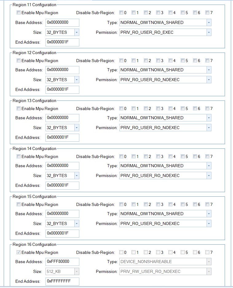

        The code often run away into the invects table-DataEntry after I enable the mpu. Can you tell me what the reason is?please!
        The mpu config is the default config by HCG as pictures below:

    Can you configure the Async EMIF memory region to MPU device mode?

    My development steps are as follows:
    1、write the data-0x5A6B to address 0x68000003 without enable the mpu,the code as follow: (*(uint16*)(0x68000003)) =0x5A6B;
          but the nWE signal was pulled down twice  in one CS low period, the first time send 0x5A00 to fpga,the second time send 0x006B to fpga.
           so I enable the mpu  and the mpu configuration as above shortcut pictures.
          Then I still run the  (*(uint16*)(0x68000003)) =0x5A6B; the system code will run away and into the Abort invect (dataEntry) where in the file named        "HL_sys_intvecs.asm".
    2、I try to write the data-0x5A6B to address 0x6800000C with the mpu:(*(uint16*)(0x6800000C)) =0x5A6B;
         Then the system code run normal , the nWE signal was pulled down one time,and directly send 0x5A6B to fpga.These results are exactly what I hope to see.
         Then I test run these code:(*(uint16*)(0x6800FFFC)) =0x5A6B was run ok; (*(uint16*)(0x6800FFF1)) =0x5A6B was run away;(*(uint16*)(0x6800FFF2)) =0x5A6B was run away;
         so I find I can't operate the bit0 and bit1 of the 0x68000000 in the background of enable the mpu function.
    I don't quite understand the principles!

  • Hi Jiangbo,
    Per ARM TRM, only the Normal Memory type attribute supports unaligned accesses.
