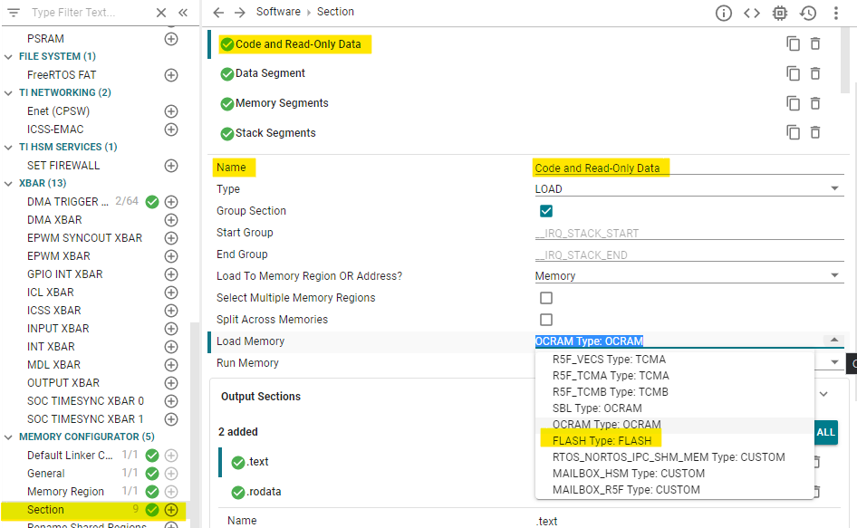

I tried to dig a little more and found this option in sysconfig
it doesn't work so far, while debugging getting this exception and core is going into abort mode

Cortex_R5_0: Writing 1 chunk at offset 0x100000
Cortex_R5_0: Trouble Setting Breakpoint with the Action "Finish Auto Run" at 0x601050ec: (Error -1066 @ 0x601050EC) Unable to set/clear requested breakpoint. Verify that the breakpoint address is in valid memory. (Emulation package 12.6.0.00029)
Cortex_R5_0: Breakpoint Manager: Retrying with a AET breakpoint
Hello Sarun,
For 263x load and run is supported only when both addresses (load, run) are in RAM.
