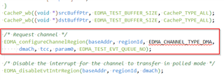

we are implementing a software resolver, employing a 10kHz sine wave, synthesized using DAC via EDMA and a samples' table in RAM (we have referred to the dac_sine_dma example in the TI SDK). We need to also use the EDMA to communicate via QSPI with an external flash. This interacts with the sine wave generator, producing a glitch on the output like the one shown in the picture.
Is there a way to continously geneate a sine wave whilst using EDMA for other purposes?
