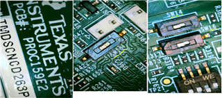

What is the switch configuration needed for SW14, SW15, and SW16? I have all switches open, but I am not certain this is correct.

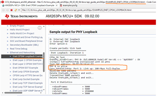

    I tried to send UDP packets to the Control Card from the PC. I see in Wireshark that this results in an ARP request. This is expected. However, I see no reply from the Control Card.
    Also, when I look at the lwip_stats struct before and after sending the packets, I see no change in any value.
    See image:
    Is it safe to assume that the Control Card is not able to receive Ethernet communications through the on-board RJ-45 port?

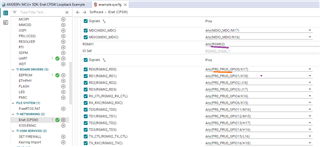

    3)
    The issue with the printf() not functioning was resolved. For some reason the SysConfig->Debug Log -> Enable CCS Log was not enabled for this project.
  • Hi TollMan,
    You can see the CPU load printed on UART Terminal.

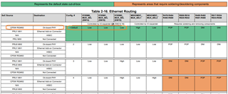

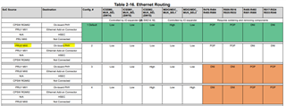

    This is wrong,please refer to the user guide of AM263Px CC section 2.16 for more details on switch configuration
    www.ti.com/.../spruj86b.pdf

    "This is wrong,please refer to the user guide of AM263Px CC section 2.16 for more details on switch configuration"
    I reviewed the User's Guide. I'm posting this prior to comparing to the schematic for the sake of a rapid response.
    Looking at Table 2-16 I think I should probably be closing SW15 (to pull high ICSSM2_MUX_SEL high).
    I tried to ping again from the connected PC, but I see the same symptoms:
    a) ping response is "destination unreachable"
    b) on Wireshark I see no response to the ARP Broadcast.

    I want to rule a switch/jumper configuration mistake. Please check:
    ... and let me know it there is any other image that would be helpful.
    Tollman

  • 5b)
    It occurred to me that perhaps I've been focusing on switches, but the issue may be the resistor jumpers (POP/DNI):
    Is it true that I need to modify my EVK for this to work?
  • Is there any changes in your syscfg as compared to in the default example(I have shared the pic of my configuration which is the Out of box configuration also).

  • I want to rule a switch/jumper configuration mistake. Please check:
    Can you put SW15 to OFF and try?
  • Hi Nilabh,
    As suggested, I changed SW15 to off (back to the original position), and re-tested. After doing so, I see the same results. Namely, when I ping from the PC, I see:
      * ARP requests in Wireshark upon PING.
      * ICSS_EMAC_rxInterruptHandler() breakpoint is not hit upon PING.
    Please confirm:
    The Control Card switch/jumper configuration should be configured such that "PRU0 MII0" is routed to "On-board PH" for this test as highlighted here:
    Tollman
  • Hi Tollman,
    Now things are pointing towards a faulty board.I am sharing pic of my board. If everything is same on your board too, Can you try with a different board

    However, the PHY loopback does not seem to work
    <printf2>
    [Cortex_R5_0]
    0: Internal MAC loopback
    1: External PHY loopback
    Enter option: =============================
    Enet Loopback: Iteration 1
    CPSW_3G Test
    EnetAppUtils_reduceCoreMacAllocation: Reduced Mac Address Allocation for CoreId:0 From 4 To 2
    EnetPhy_bindDriver: PHY 0: OUI:080028 Model:0f Ver:03 <-> 'dp83869' : OK
    PHY 0 is alive
    initQs() txFreePktInfoQ initialized with 16 pkts
    Cpsw_handleLinkUp: Port 2: Link up: 100-Mbps Full-Duplex
    </printf2>
    Do you agree?
    What SW14, SW15  SW16 positions need to be configured for the PHY loopback?
  • Hi Nilabh,
    I did some additional testing with "Enet CPSW Loopback Example" on PCB #2.
    I found that some packets are being dropped during the PHY Loopback.
    I halt the processor after a few seconds aan see it is looping in the loop:
        while (txRetrievePktCnt != txCnt) {...}
    It appears that "Enet CPSW Loopback Example" is using "PHY 0"
    ... corresponding to RGMII2 (P0_PRU0):
    ... and with my current hardware configuration:
      SW14 open
      SW15 open
      SW16 open
    ... should be routed to the On-board PHY.
    This loopback test seems to indicate that, although there are dropped packets, the PHY is functional, and the MAC to PHY (RGMII2) is functional.
    1)
    Do you agree with this analysis?
    2)
    Can you try  "Enet CPSW Loopback Example" on your Control Card? Do you also see dropped packets?
