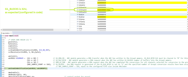

    And a "zoom" of the ADC DMA configuration register:
        #define ADC_SAMPLE_COUNT 32U // Equal to the configured FIFO size in HALCoGen
        adcREG1->G1DMACR = (1U << 0U) |                // G1_DMA_EN - ADC module generates a DMA transfer when the ADC has written to the Group1 memory. G1_BLK_XFER bit must be cleared to ‘0’ for this DMA request to be generated.
                           (1U << 2U) |                // G1_BLK_XFER - ADC module generates a DMA request when the ADC has written G1_BLOCKS number of buffers into the Group1 memory.
                           (1U << 3U) |                // DMA_G1_END - ADC module generates a DMA request when the ADC has completed the conversions for all channels selected for conversion in the group1.
                           (ADC_SAMPLE_COUNT << 16U);  // G1_BLOCKS - One DMA request is generated if the G1_BLK_XFER is set to ‘1’ and the specified number of Group1 conversion results have been accumulated
                                                           // ADC_SAMPLE_COUNT = 32U, equal to the configured FIFO size inside HALCoGen
    Although I ended up with DMA transfers, I still have the following concerns and observations.
    1. Buffer content
    Edited after my initial mistake with the hard-coded index 0 in the loop (sorry for the confusion).
    The result is the following - only one value is sampled, all the others in the buffer are 0s.
    [0] Ch: 6, ADC: 420
    [1] Ch: 8, ADC: 0
    [2] Ch: 8, ADC: 0
    [3] Ch: 8, ADC: 0
    [4] Ch: 8, ADC: 0
    [5] Ch: 8, ADC: 0
    [6] Ch: 8, ADC: 0
    [7] Ch: 8, ADC: 0
    [8] Ch: 8, ADC: 0
    [9] Ch: 8, ADC: 0
    [10] Ch: 8, ADC: 0
    [11] Ch: 8, ADC: 0
    [12] Ch: 8, ADC: 0
    [13] Ch: 8, ADC: 0
    [14] Ch: 8, ADC: 0
    [15] Ch: 8, ADC: 0
    [16] Ch: 8, ADC: 0
    [17] Ch: 8, ADC: 0
    [18] Ch: 8, ADC: 0
    [19] Ch: 8, ADC: 0
    [20] Ch: 8, ADC: 0
    [21] Ch: 8, ADC: 0
    [22] Ch: 8, ADC: 0
    [23] Ch: 8, ADC: 0
    [24] Ch: 8, ADC: 0
    [25] Ch: 8, ADC: 0
    [26] Ch: 8, ADC: 0
    [27] Ch: 8, ADC: 0
    [28] Ch: 8, ADC: 0
    [29] Ch: 8, ADC: 0
    [30] Ch: 8, ADC: 0
    [31] Ch: 8, ADC: 0
    I also tried with adcResetFiFo() before and after adcStartConversion() - the behaviour (the buffer content) is absolutely the same.
    2. The value of G1_BLOCKS
    I noticed that adcStartConversion() changes the G1_BLOCKS from 32U to 31U. Then, the register "automatically" recovers to 32U:
    Is this normal?
    3. The G1_DMA_EN bit
    I do not observe any difference in the program behaviour when the G1_DMA_EN bit is 0 or 1. What should be the recommended configuration for this scenario?
    Thanks and regards,
    Varban

  • Hi Varban,
    Can you please refer below example configurations and code:
    ADC_with_DMA_RM46.zip
    In above project i was able to successfully be transferred the 20 samples of channel-6 to the other RAM buffer using DMA.
    I think the main difference from your project is that, here i enabled the continuous conversion mode instead of single conversion mode.
    I enabled this because if we didn't enable this continuous conversion mode, whenever we gave start conversion the channel-6 data always storing at single location of the ADC RAM memory.
    I think this is expected only i mean single shot mode will only do the conversion one time for all the enabled channels and will store the data in the ADC RAM. If we enable 6th channel, then only its data is storing every time at the first location of the RAM.
    Thanks & regards,
    Jagadish.
  • Hi Jagadish,
    Thanks for your response!
    My observations in continuous mode were exactly the same.
    However, is it still the case that DMA is not recommended to be used with continuous mode, as stated in this thread: e2e.ti.com/.../tms570lc4357-dma-with-adc-in-continuous-mode?
    Varban
  • Hi Varban,
    I think this is true.
    Even i if you verify my converted result also as you can see for last 4 conversions EMPTY flag got set:
    As they said, there seems like some timing issues between continuous mode with DMA.
    And also, as we select single channel for this conversion mode right, so the conversions will happen very quickly.
    As you can see the conversion time for one channel is just 1.6us, so that means we will get samples at every 1.6uS. I think we don't need the samples with such low interval.
    Maybe this is the reason they are preferring to use either timer or PWM for samples generation.
    Thanks & regards,
    Jagadish.
  • As you can see the conversion time for one channel is just 1.6us, so that means we will get samples at every 1.6uS. I think we don't need the samples with such low interval.
    And from what I have observed - in case of DMA, one may need some state machine based on interrupts (to indicate the new transfer completion), and the interrupts (even with very simple and fast handling) may choke the RTOS flow.
