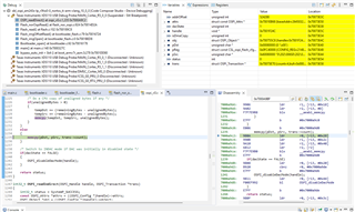

If I compile the above example, with its default sysconfig settings (specifically "Application Image is X509 Signed"=ON & "Disable Auth For Application Image"=OFF), and flash it to OSPI then it always fails to boot my system image.
If I use the mcu_plus_sdk_am243x_10_00_00_20/tools/boot/sbl_prebuilt/am243x-lp/sbl_ospi.debug.hs_fs.tiimage prebuilt bootloader then my system image boots fine.
Example sysconfig settings:
I have debugged the bootloader, below is the call stack, and the line it fails on.
When this line is hit, I get a data abort.
Please pay attention to pSrc / pDst of the memcpy.
Note: For debugging purposes I can put a Flash_read() statement that reads flash offset 0x80000 and does not cause a data abort. I am therefore thinking 0x80000 in pDst is not a valid destination for the memcpy?
Please can you advise on this problem. I am currently developing a custom bootloader where I also run into this same problem.
Is the prebuilt SBL bootloader compiled with certificate auth turned off? Is this related to the problem, or is something else going on?
    Thanks for your patience.

    Can you try to put the destination buffer in MSRAM?

    So I assume this is the buffer you'd like me to setup?
    That is correct. I checked the .app section in the file named sbl_ospi.release.map.
    It is allocated under MSRAM, so you have to make sure your destination buffer is in MSRAM in this case.

    The call stack in the screenshots on my first post are from the example, with the only change being that I put the call to loop_forever() at the start so I could connect the debugger while the bootloader was running.

    I have checked your screenshot.
    I am assuming it was from file main.c for SBL OSPI.
    On this note:
    For me I do not see the call to Flash_imgOffsetRead inside Flash_imgOpen
    But in your screenshot how come do you have this call?
    Can you explain?
    Vaibhav

    You're looking at SDK version 10.0.1 and I'm using SDK version 10.0.0.
  • I am looking at 10.0 itself:
    I see both 10.0 and 10.01 has the same definition:
  • I'm going to reinstall mcu_plus_sdk_10.0.0 and check again.
  • I've re-installed the SDK and that function call is not present.
    I can only assume that we modified bootloader_flash.c at some point during development / testing.
