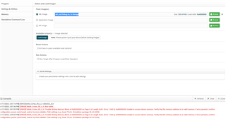

I have a question regarding use of TI UNIFLASH tool for flashing AM2432. In particular, I have to write code in Flash with OSPI controller.
On my board I have only two boot mode possibilities:
- NO BOOT
- OSPI BOOT
I need to flash AM2432 avoiding sbl_jtag_uniflash program and if I can use a tool like TI UNIFLASH can be good in OSPI BOOT mode.
Is there a way to program my board with this tool with these two boot modes? Do I have to prepare some loader for using this tool?
Up to now, I saw that it's possible putting device in UART BOOT MODE.
Regards.
Stefano
Hi Stefano,
TI Uniflash has an option for flashing via JTAG in No boot/Dev boot mode but that also uses sbl_jtag_uniflash. If you only have these 2 boot mode options then sbl_jtag_uniflash if the only option in SDK available for flashing.
