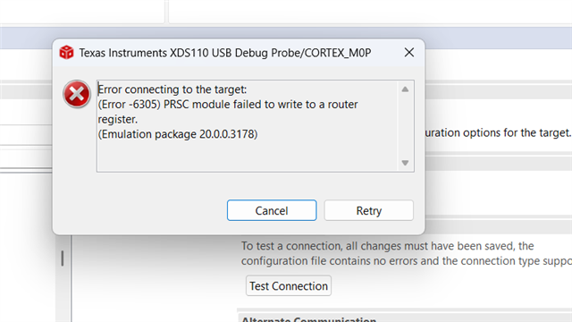

Dear Team,
We are experiencing an issue while programming the MCU using the XDS110 debugger.
The error is encountered during the programming attempt. The MCU used in our design is MSPM0C1104, interfaced with MCF8315D. All power supplies generated from the MCF8315D have been verified and are within the expected voltage levels.
Despite correct power behavior, the MCU is not being programmed successfully.
We request your guidance on the appropriate corrective actions to resolve this issue.

  • Hi Sourabh,
    It seems the image you shared is not visible. Can you share it again? Also, what software tool are you using to program the device? Finally, can you prove the SWD lines to check if there is any signals coming from it?
    Diego Abad
  • This error we got while connecting the debugger.
  • Hi Sourabh,
    The error you are seeing is typically attributed to an issue in hardware, such as with power supply.
    There are several E2E threads related to this issue that may be helpful:
    The MSP team also performs schematic reviews on Fridays. If this is something you are interested in, please reach out to your local Technical Sales Representative (TSR) or Field Applications Engineer (FAE).
    Owen
  • Dear Team,
    I have tried all the above suggestions but still face PRSC -6305 error.
    This circuit we are using in our boards
    Please suggest to us, we are also ready for the conference call. Please share your availability.
  • Hi Sourabh,
    Based on your schematic, the only suggestion I have is to use a 47kOhm pull-up resistor on nRST, which is the recommended value.
    From the , the error you observe occurs under theses causes:
    With that in mind, are you writing to NONMAIN?
    Can you probe and share a capture of the power supplied to the device when attempting to program the device?
    Can you try using an external power supply for the MSPM0C1104, rather than from the motor driver?
    Have you tried an A-B-A swap of the device on your board?
    Owen
  • We have changed the resistor to 47kohm.
    Also, if we are supplying AVdd from an external source, then the MCU is programmed. And no PRSC error is observed.
    But if the external PS is removed and AVdd connects, the voltage drops 1.8-2.2V.
    What is the cause of it?
  • Hi Sourabh,
    The issue is likely that the motor driver is also drawing current when you are flashing the MSPM0C1104. I would suggest using an external power supply if possible, but if that is not possible, then I would suggest keeping the motor driver in a low power mode or sleep/shutdown mode while debugging the MSPM0C1104.
    Owen
