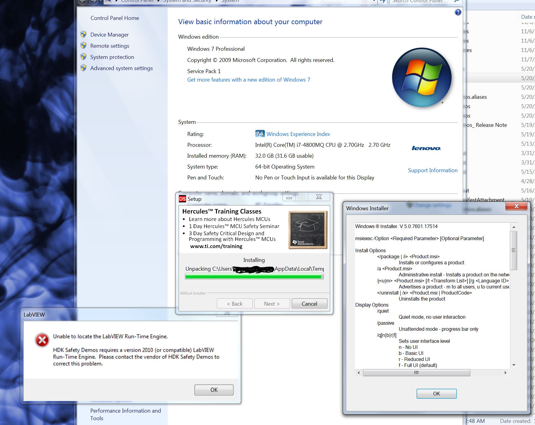

Install freezes. Screenshot attached with all relevant info. Ignoring installation freeze, get runtime missing error.

I had already looked through the similar support threads and did not find a solution. I also don't have the launchpad eval board you mentioned as part of the tutorial link. We paid $200 for a TMS570LC43 eval board which is what I'm trying to get working. It included an install CD with CCSv6 which also had installation issues when I tried to check for and install updates from the help menu. I'm really surprised at how poorly things work out of the box.
Just an update. Although the executable installer failed for some reason, I was able to manually install the labview runtime executable and uniflash tool and get the demo running. Some constructive feedback - someone should document exactly what the installer is installing so in the event of some weird incompatibility, one could manually get a complete install. A list of files and separate install packages would be helpful. In it's current state, I had to reverse engineer the install process (which was a pain).

I am glad that you were able to get the demo code running and, again, offer my apologies for the issues that you have experienced. As was explained to me, there was some issue created in the last release of the installer where the Labview runtime library was not installed correctly or there was some issue with the registry entry for it. Unfortunately, I don't have all the details.
