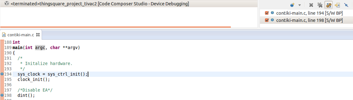

I'm trying to make the Stellaris In-Circuit Debug Interface work on a Tiva C TM4C1294 Connected LaunchPad from Code Composer Studio 6.0.1 in Ubuntu 12.04 where the used compiler is GNU v4.7.4 (Linaro).
I have made a simple CCS Project and chosen to "Reset target during program load to Flash memory" under the Project Properties -> Debug -> Flash Settings.
The problem is that I'm unable to make it stop at a breakpoint.

Using CCS 6 running under Linux with a EK-TM4C123GXL I haven't been able to repeat the failure. The sequence was:Jesper Hansen said:If I set the breakpoints before the debugger is run, it will automatically make a software breakpoint, which is the reason why it didn't halt. If instead I change the breakpoint to hardware breakpoint while it is debugging, it will succesfully halt at the right spot.
1) Set a breakpoint when no active debugging session. The Breakpoints Window reports that apparently that a S/W break point has been set.
2) Start a debugging session. The Breakpoints Window now reports that the breakpoint is now a H/W breakpoint.
3) Resume the program, and the breakpoint is hit.

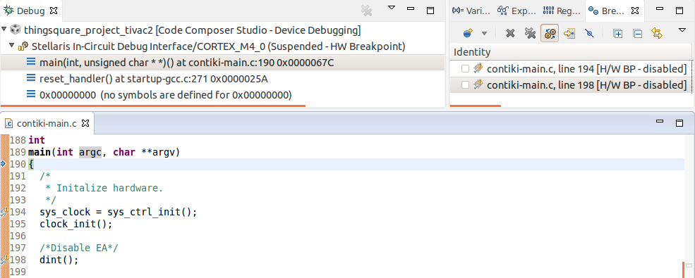

Here is what happens:
I disable "Allow software breakpoints to be used" in "Debug -> Misc/Other Options" and set two breakpoints before running the debug session:
Then when I start the debug session, the two S/W breakpoints will be turned into H/W breakpoints, but they are now disabled.
I guess it's just some option that I have not correctly set.
Do you have any ideas?
Thanks, Jesper
I still can't repeat the problem.Jesper Hansen said:Do you have any ideas?
When you hover the mouse over the breakpoints with the "exclamation marks" symbol on them, is there any explanatory text displayed about why the breakpoints are disabled?
If you right-click on the disabled breakpoints, and display the breakpoint properties, what is displayed?
