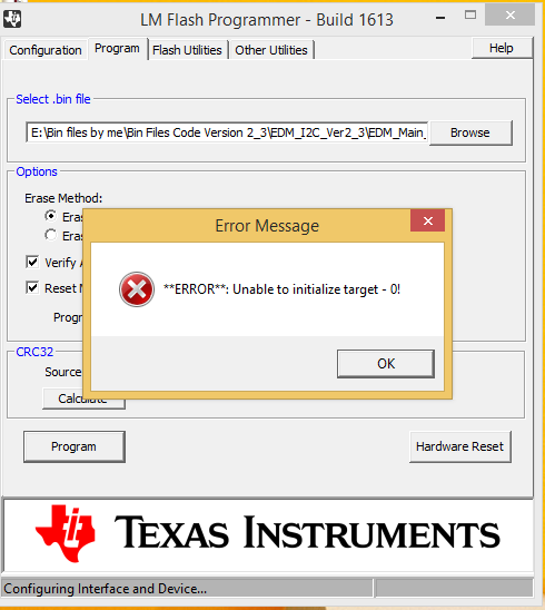

          I am using Windows 8.1, 64Bit, 8GB RAM configuration PC. I am Using customized board of TM4C123GH6PZ, and for Debugging and Programming I am using TI Tiva C Series Launchpad and CCS 6.0.1 and LM Flash Programmer Build 1613. For Programming I use either CCS or LM Flash. Every Time when I try to program I am getting this error message "**ERROR**: Unable to Initialize target - 0!". Most Important thing is I used same customized board, Launch Pad, CCS since last 3 months but didn't face such problem and now also it is working on other PC and I can program using that PC but It is not working on my PC nowdays, So my first conclusion is

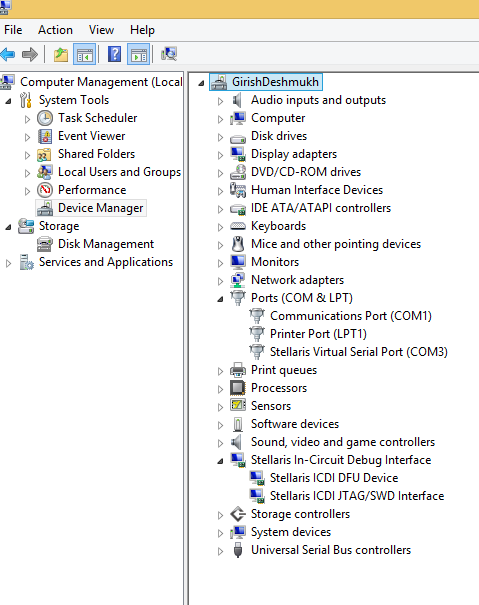

1 Port detected properly

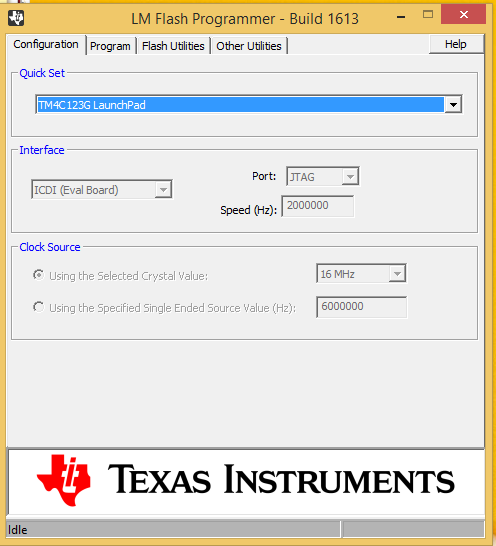

 2. Setting at LM Flash
3. Error at LM Flash

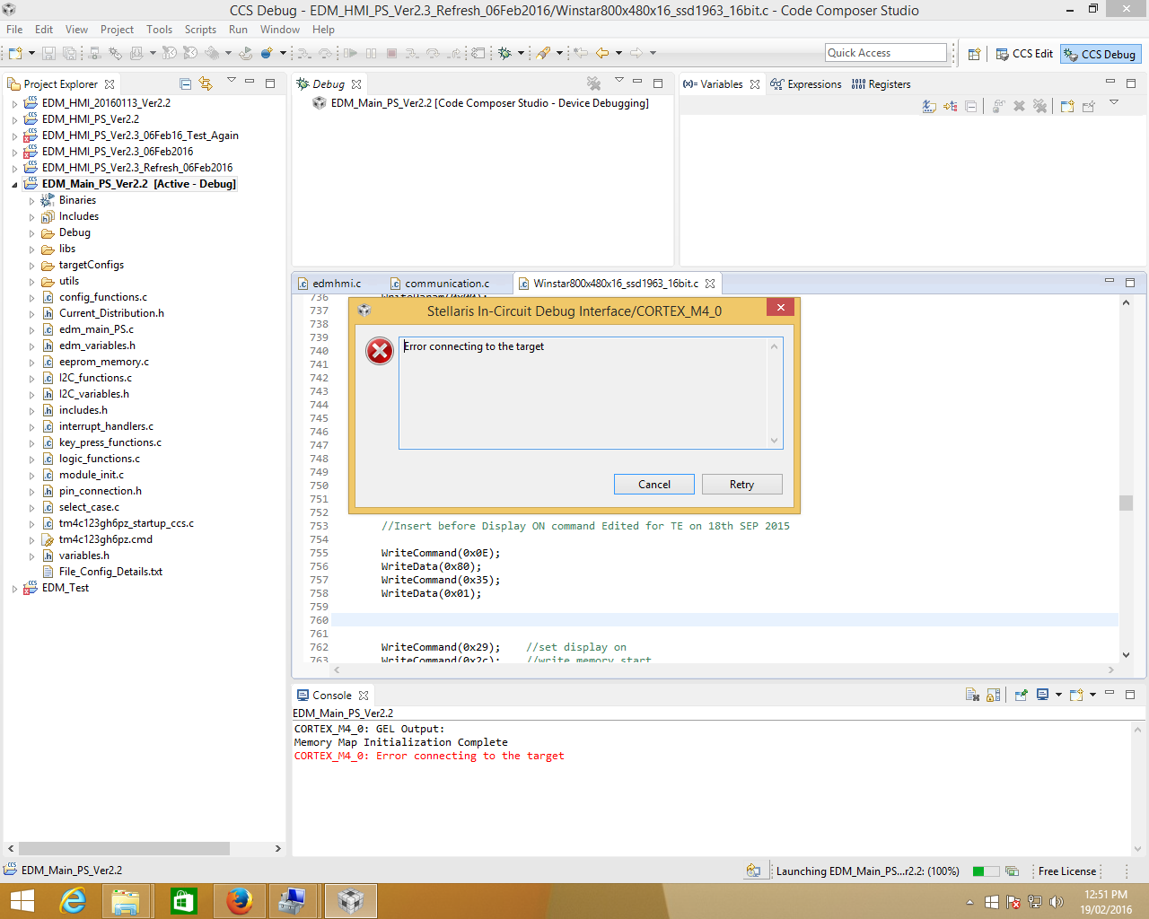

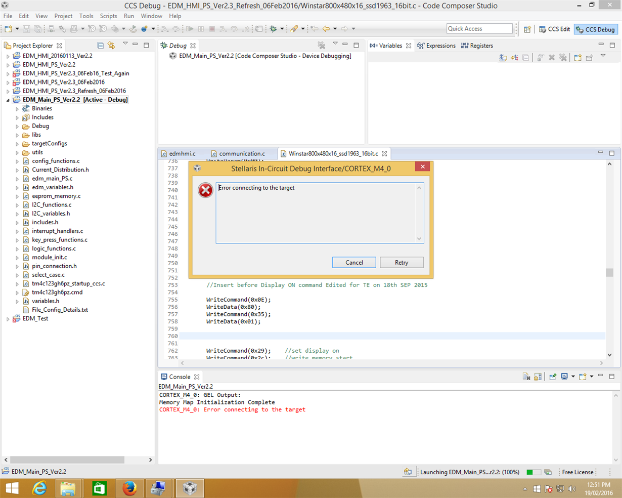

4. Error when I tried using CCS

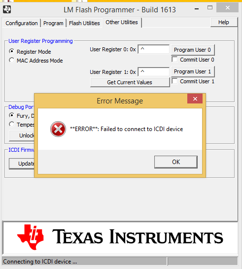

    2. I tried to do the same step from where problem started (as per my guess it may be wrong as I did so much R & D on that) i.e. Update ICDI Firmware in "Other Utilities tab" in LM Flash programmer but this time it is not updating the driver where as it is showing an error "**ERROR** : Failed to connect to ICDI Device"
    Hope it may give you a clue to suggest an expert solution. Thanks
    Here is an image of the error
