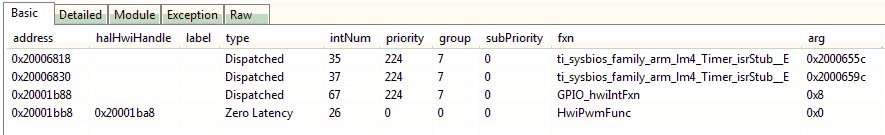

I was implementing three 200kHz Buck convertors. Each Buck is phased shifted and runs every 5us and uses a zero latency interrupt from the ADC to run a fixed point 3p3z controller (software optimized). Every 10ms a SWI timer is run to calculated floating point values for soft start. The idle task just flashes a LED and performs TCP/IP and USB communications.
But I found my SWI function was sometimes hitting some of my asserts. When I looked at “ret” it was between 0 and ADC_VALUE_MAX, or it was “NaN”.
    if (ret >= 0.0f && ret <= ADC_VALUE_MAX)
    	//ok
    else
        assert(ret >= 0.0f && ret <= ADC_VALUE_MAX); //hits this line
At first I though it was because I was using floats in my HWI Buck function, so I re-wrote it to use integer maths only.
Then I realized I had to mark the HWI Buck function as “__interrupt” for the correct context saving to occur.
I’ve done all of this and still my SWI function was being corrupted so I decided to write a small test program to reproduce this error. This code doesn’t perform the buck or soft start code, but contains the bits of code that seems to cause the error. I made the SWI code run for almost 10ms and changed the HWI to run just one buck every 5us.

  • hi,
    I use Sys/Bios to set up the HWI as shown below
    	Hwi_Params hwiParams;
            Hwi_Params_init(&hwiParams);
    	hwiParams.priority = 0;  //0 = non-handled, non-zero = Sys/Bios handled
    	hwiParams.enableInt = true;
    	Hwi_create(INT_PWM0_0, (Hwi_FuncPtr)HwiPwmFunc, &hwiParams, NULL);

  • hi,
    I'm not sure what this piece of code is doing, but I don't think it's the problem. I was just highlighting the fact that the author didn't want that piece of Sys/Bios code interrupted.
    When I look at the Execution graph I can see the system is being interrupted every 1ms by the system tick HWI and 1ms SWI Post.
     You can also my SWI running for about 7ms which gets corrupted.
    What isn't shown is my zero latency (eg non-handled Sys/Bios interrupt) which is running every 5us. I think my HWI is interrupting the 1ms system tick HWI which is doing something naughty and relies on the fact that it's code doesn't get interrupt, eg something like the code example I posted.
    So I think I will look at ti_sysbios_family_arm_lm4_Timer_isrStub__E (#defined to Timer_isrStub) to see what it's doing.
    cheers

    I think my 5us HWI is interrupting the Sys/Bios 1ms system tick, but the Sys/Bios ti_sysbios_family_arm_m3_Hwi_dispatch__I is doing something where it doesn't expect to be interrupt and is ending up corrupting the SWI context.
    2. You should dump out the priority table from the NVIC and confirm that your Buck function is actually running at a higher priority than the rest of the system. Beware - the NVIC numbers priorities backwards from what you might expect.
    I looked at the NVIC and it looks like my HWI is the highest priority. Here's a screen shot from CCS
