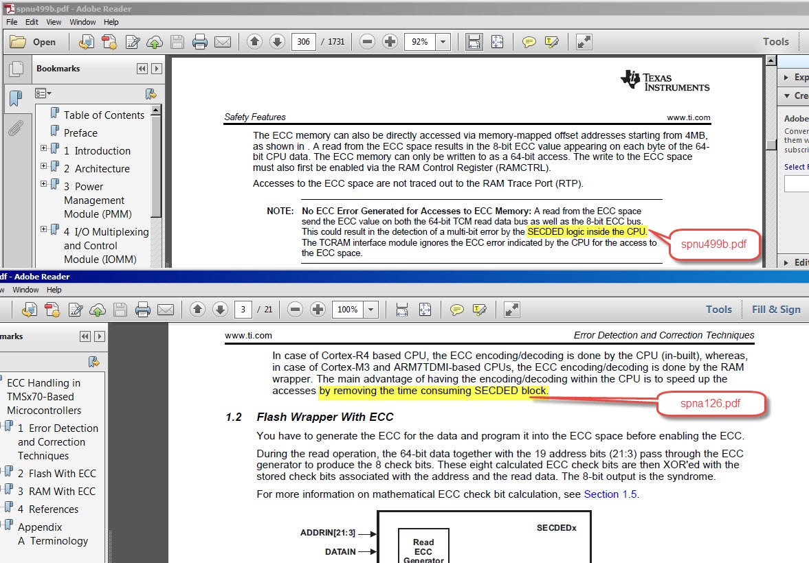

Hello Support,
In the spna126.pdf it is mentioned that ECC encoding/decoding logic is resident with Cortex-R4 side and "time consuming SECDED Logic is in the Flash Wrapper".
In spnu499b.pdf, it is mentioned that SECDED Logic is inside Cortex-R4.
I have attached the following snippets from the above mentioned document for easier reference.
Can you please explain ECC complete signal chain is divided between Flash Wrapper side and Cortex-R4 side?
I am assuming it consists of following sub-blocks:
ECC Encoding Logic -- For k bit data it produces n-k bits of ECC
ECC Decoding Logic -- For n bit input, it calculates n-k bits of ECC
SECDED Logic for Error Detection -- Detects if there is more than one bit error and if it is only one bit error then it corrects it
Thank you.
Pashan
  • Hi Pashan,
      Which device are your referring to? You are quoting from the below statements in spna126.
    In case of Cortex-R4 based CPU, the ECC encoding/decoding is done by the CPU (in-built), whereas, in case of Cortex-M3 and ARM7TDMI-based CPUs, the ECC encoding/decoding is done by the RAM wrapper. The main advantage of having the encoding/decoding within the CPU is to speed up the accesses by removing the time consuming SECDED block.
      For all Hercules R4 based devices with ATCM and BTCM interfaces they ECC checking is completely done inside the CPU. What is connected to the ATCM is the flash memory excluding the EEprom emulation bank and OTP sectors. What is connected to BTCM is the SRAM. The CPU does all ECC checking for the flash memory (the normal banks such as bank0, bank1) and BTCM (the SRAM). However, for Bank7 (the Emulation flash bank) and the OTP sectors, they are accessed via the CPU's AXI bus interface. The AXI bus interface does not have ECC checking capability. Therefore, the ECC logic is replicated inside the flash wrapper only for accesses to the flash EEprom emulation bank and OTP.
