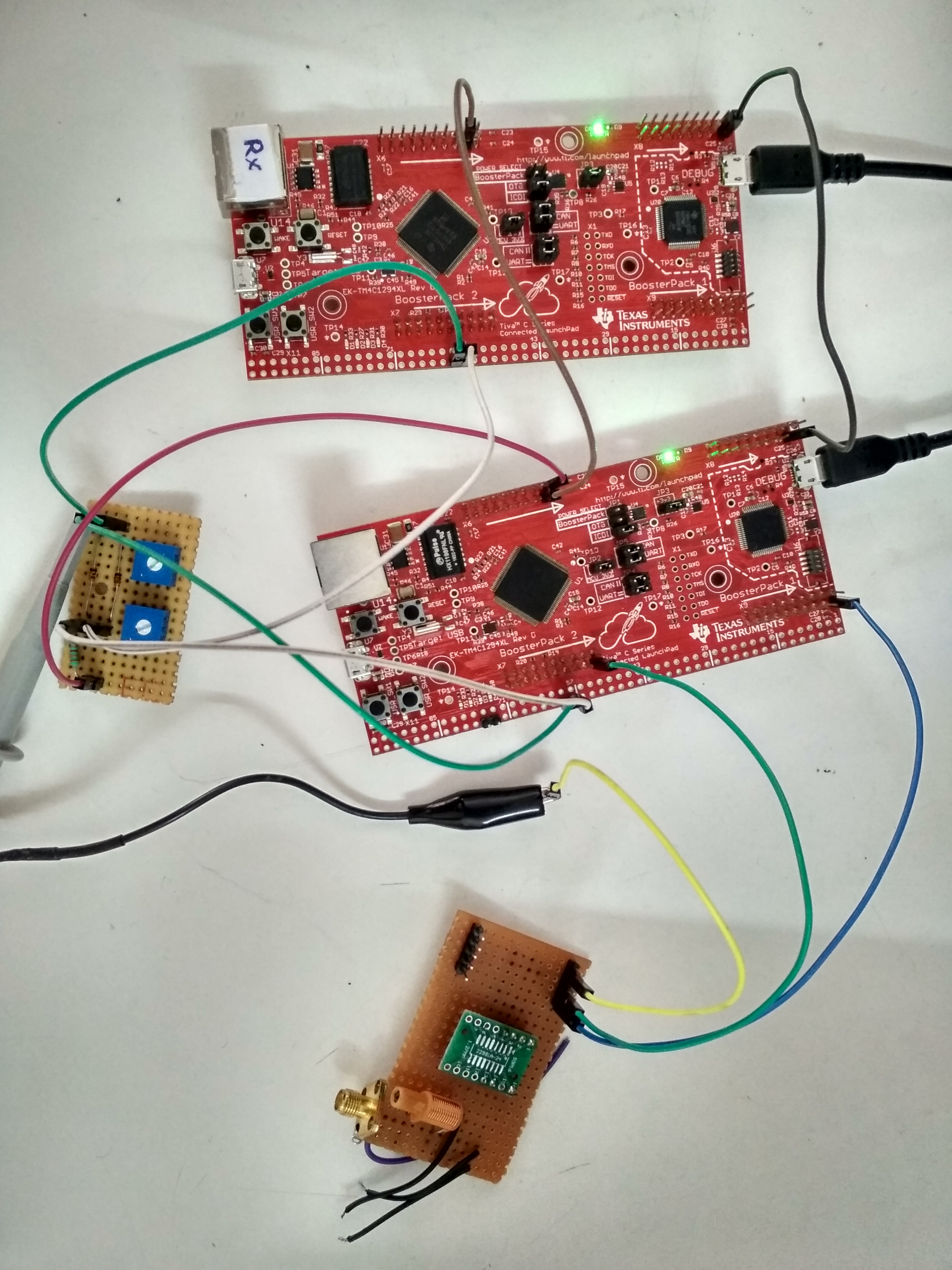

I am working on CAN bus.
I am using simple_tx and simple_rx code given in example folder (peripheral-CAN).
I have modified that code since I don't want to use UART and made code simple.
I have followed this thread:
But this doesn't work for me.

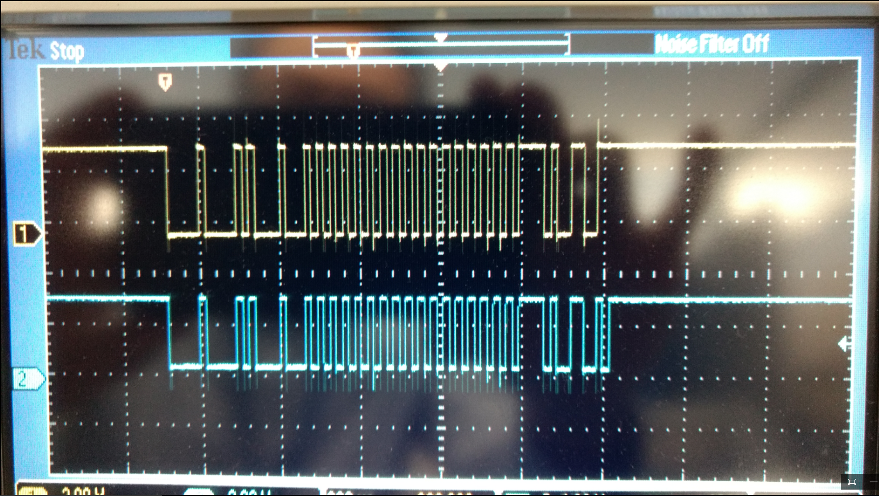

Different hardware connections and corresponding output waveform, I have attached in following document. Please see that.
and the hardware connection :
All jumpers are in default position.

I think I have done some mistake in hardware or in code. I am not able to debug that.
Amit suggested SN65HVD233-HT 3.3-V CAN Transceiver.
Is it issue of MCP2551 CAN Transceiver because of voltage levels(TTL)..???
I have tried LVTTL to TTL convertor and TTL to LVTTL convertor , SN74LV244A and SN74LVC4245A. Still getting same error.
