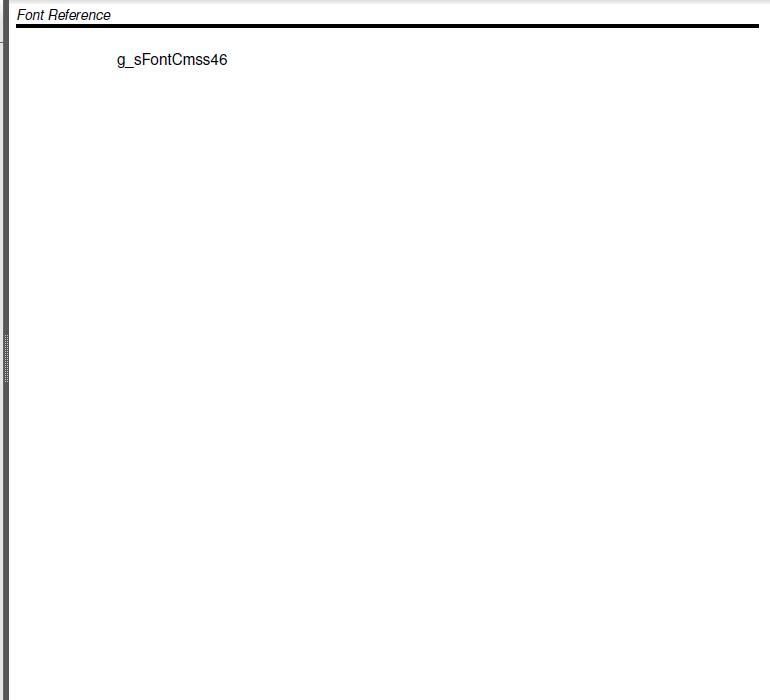

    • The GRLib User Guide promises a 'Pictorial Review' of (many) of  ftrasterize's 'creations.'      One of the LOUD 'Knocks' we had past heard about such compression programs - they produce fonts which are (pardon) 'ugly.'     We thus raced to Section 16 of our Graphic User Guide - and met 'Page after Page' of  BLANK  SPACE - NOT ONE demonstration of ftrasterize's output - revealed!    Mine is marked, 'Literature Number: SPMU300E,  SW-TM4C-GRL-UG-2.1.4.178  - April 2013 - Revised February 2017.   (that's believed to be 'reasonably' current - is it not?    Why are ALL of the rasterizations BLANK?    We provide multiple 'page captures' - to illustrate that EXPANSE of Blank space.
    • The originating poster 'specifically requested' Fonts beyond 100 points.    And today we learned - that ftrasterizer - 'tops out' at 100 points!    (will NOT run - beyond that 100 point limit!)
    • We learned as well - that even during ftrasterizer runs of < 100 points - certain 'wide' chars - may not be properly rendered.   (they are revealed as, 'requiring beyond 256 bytes' - w/out further explanation!)
    • While the 'ftrasterizer command' (teases) by allowing an (apparent) 100 point char height - in reality - about two-thirds of that - is the best that may be realized!   (a good 1/3 of that 100 point total - is devoted to 'lower-case' character 'descenders' - and 'inter-line' spacing.    While (not) rising to a breach in, 'Truth in Advertising' - what's suggested - is NOT Delivered!
    • There IS mention of a 'wrapper' - which (may) enable font storage (as someone here earlier proposed) - off chip.   (MCU)    Yet the Graphic User Guide notes that such is not provided - and appears reasonably demanding - as well.
    • The data we've extracted - and share w/the group here - reveals (most) of the font compressions to produce a 'Character Aspect Ratio' of  '6:7.'     Now having worked in the Display Biz - it is known that '5:7' proves most pleasing - and the output of 'ftrasterizer' appears to produce a far more 'blocky' (near square) character.    We all wanted to see that output - blank pages (alone) - filled our 'salt encrusted screen.'
    Follows now - support documentation - of these findings...
    Our search for 'Red October'  (ftrasterizer's output) revealed (consistently):
    and
    and these BLANK IMAGES continued - upon EVERY SINGLE - 'Font Illustrative' Page...        Did I say ...  that I (really) liked the 'font compression'?'       HOW (really) may we review the compressed font's appearance?

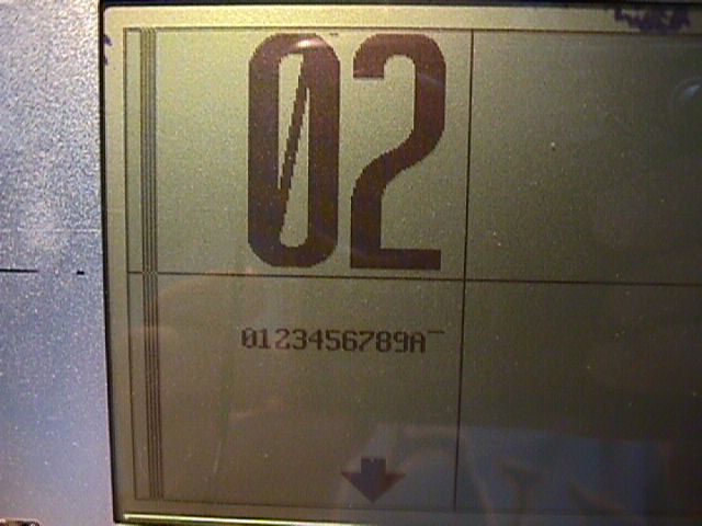

  • Here are two (very) large fonts we (past) developed for our defense clients:    (before even 'LMI' (founders of Stellaris) was born!)
    This particular screen was used 'LIVE' w/in the desert - during 'action.'     The 'frit-seal' atop the Lcd was pierced - due to intense heat & severe shock/vibration - yet still the display - and our firm's electronics - carried on.    I believe this Graphic Controller was our first to use ARM - this one an AT91SAM7S - out prior to LMI's ARM Cortex M3.     (may they rest in peace - but for the 600 - we retain in stock...)
    This one 76 pixels tall:   Screen is QVGA  -  320x240 pixels  - 4.7" diagonal
    and this one is 112 pixels tall  (both screens are QVGA - 320x240 pixels - 4.7" diagonal
    Note that the larger (4.7" diagonal) screen produces a (naturally) larger character - independent of the point or pixel number.    The 112 pixel font was 'clipped' (you can see that at its top) the '0' was a truly - 'Auto-Scaled Font' - the '2' was bit-mapped.    Note the base-font - approximately 30 pixel rows beneath the 112 pixel '0.'
    So yes - there are several 'ways out' - and you (are)  welcome...
