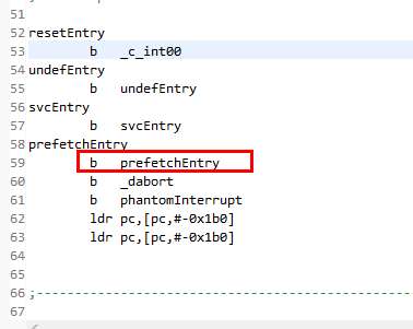

At present, because the MPU protection is triggered, the program enters prefetchEntry, but I want to do some software reset operation after entering prefetchEntry. How to implement prefetchEntry?

    You can issue the SW reset in prefetch ISR.
    1. change the sys_intvec.asm:
    .ref _prefetch_entry
    prefetchEntry
    b _prefetch_entry
    2. add one function in your sys_main.c or other place
    void _prefetch_entry(void);
    #pragma CODE_STATE(_prefetch_entry, 32)
    #pragma INTERRUPT(_c_int00, PABT)
    //software reset
    systemREG1->SYSECR = (0x10) << 14;
    while(1);
