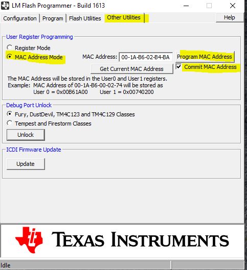

Is it possible to pre-load the internal TM4C129ENCPDT EEPROM with serial numbers or some serialization data such as unique serial number and some calibration data?  We need at least 32 bytes.
      Yes, you can use the LM flash programmer or Uniflash tool to program the MAC address on a fresh device Please see below image. If you need more than 32 bytes of data, then you need to have application code running to program the calibration data onto the internal EEprom.

    1) In the UniFlash tool you showed me yesterday.  When I put in any number on the MAC Address - say 01-02-03-04-05 and program it it says it succeeded. Then when I read it back out it reads the default value 44-f8-a-0-4.  No matter what number I put in this field it always comes back with 44-f8-a-0-4. Do i need to erase the entire chip first?  Are there security bits that I have to clear?
    When was the  44-f8-a-0-4 programmed? Did you program this value by any chance? A fresh device should have all FF-FF-FF-FF-FF-FF. If the MAC address was already programmed then you can't program another value unless you first unlock the device. The MAC address is meant to be programmed only once. An unlock operation will restore the device to the factory setting. Once the device is unlocked then you can program a new value.
