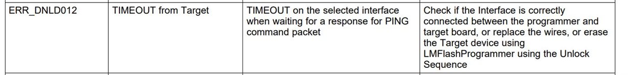

But, when I try to upload the binary of any program, I always get following Error:
ERR_DNLD012: TIMEOUT from Target
Can anyone help me resolving this issue?

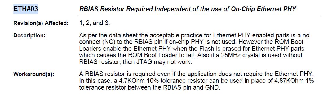

      My colleague reminds me that you are missing the RBIAS resistor per the below errata. Please add the resistor accordingly and see if it resolves the problem.
