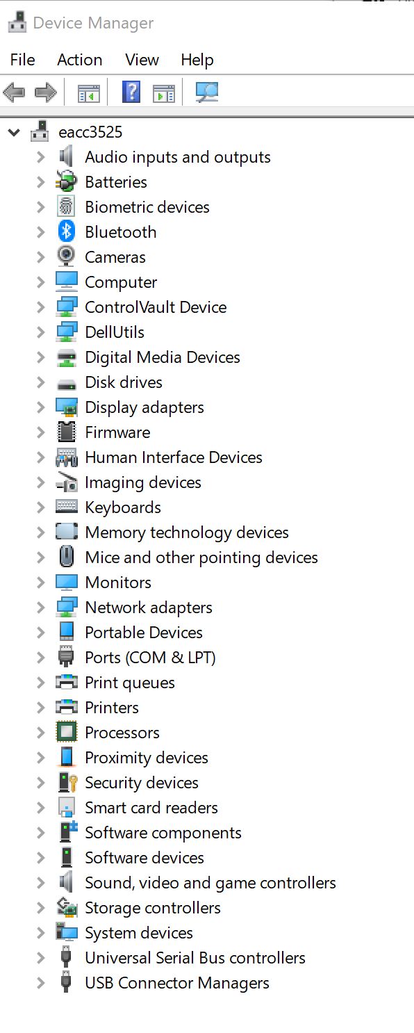

I also noticed that my device manager did not show the XDS200 any where.
Device Manager
I think the XDS200 just does not work. Looking for alternative suggestion to fix this problem.

    I am sorry to hear about that and it certainly seems so. The tests you performed indicate the Debug Probe is indeed faulty and the only last test remaining would be to try to run the same Debug Probe on another host.
    If that does not solve the case, it seems indeed this is faulty and you should talk to the company you purchased this Debug Probe and start a replacement process - I infer from your post that this probe is indeed new.

  • Hi Rafael,
    Following your advise, I connected the XDS200 to a Asus laptop in WIndows 10 to one of its USB connectors. Again, none of the LEDs light up and Windows did not recognize the device.
    I will go back to my supplier to ask for a replacement.
    Thank you for your help.
