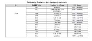

    The problem is being caused by the value at the 0xD00 register for CPU2. After a power reset, the value is always loaded as 0x****025A. With this value, CPU2 will always boot in wait boot mode, where it will stay in idle waiting for CPU1 to release it.
    When you load a program or use the restart button, the JTAG debug probe will just jump to the location of main on CPU1 or CPU2 since it knows where the program starts.
    When you reset the device, it will go back to boot ROM. For CPU1, the value at 0xD00 is determined by the boot-mode pins, and this will be set on power-up. When you software reset the device, it will boot accordingly for the value set in the last 2 bytes at 0xD00. The options are shown below.
    If CPU1 has been set to boot from flash (0x****0B5A), then it will boot to flash and go to main, if your program is stored in flash. If CPU1 is set to get boot mode (0x****035A), then it will read a location in the OTP to determine the boot-mode. By default, this location in the OTP is set to all 0xF, which boots to flash.
    Since CPU2 will always have 0x****025A programmed at 0xD00 after a power reset, it will always wait for CPU1 to release it, unless you reprogram the value at 0xD00, which the EMU_BOOT_FLASH script does.
    One other workaround that you could use would be to put a line in your cpu1 c code that tells CPU1 to pull CPU2 out of reset like shown below.
    CPU1 will get stuck at this line until it pulls CPU2 out of reset. So after both CPU1 and CPU2 jump to main, you would need to reset CPU2 (which puts it in wait boot), then you could run CPU1 and CPU2 programs.
    Please let me know if you need further clarification on any of this.
