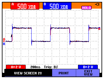

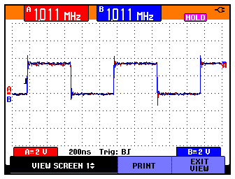

Problem still exist. Herewith I have attached waveform which shows fine duty and frequency. But if I zoom then I can see falling edge continuously moving.(I have put trigger on rising edge and continuous monitor falling edge). That movement length is 4.5nS for 1011kHz and 50% duty.
