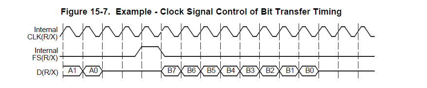

    The timings don't look too far out of the realm of possibility. 2 bit times of a 50KHz clock is 40us. I need to dig around to see if I can find the timings from the first word to it being present on the line.

    The other thing I found it interesting is that in any of the diagram that explains the mcbsp transmit, there always seem to be a 2 cycles before the frame sync pulse? Example attached:
    Also, I have tried changing the clock to 30kHz and see if this delay time would change and it did. I was getting 69us. So it is definitely related to the transmit clock time.
