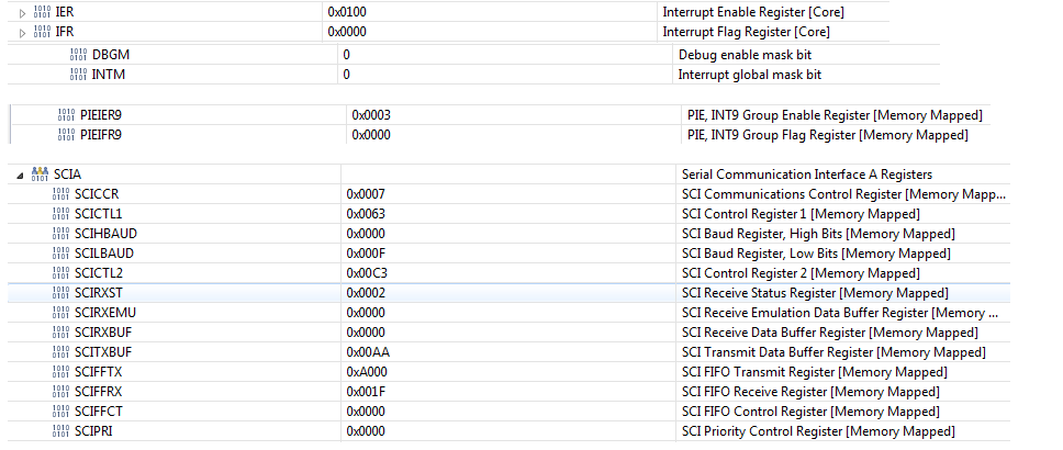

    Register values from the debug:-
    Please let me know, if I am missing anything.

  • Hello Cody,
    Thanks for your response.
    There is no change in the SCIRXT Register, all the values are zero except the RXWAKE bit, which makes sense.
    I don't think so, there is any baudrate/parity related issue. You can refer to the screenshots of the register values in debug. And, I have written the code such a way that after startup MCU transmits few bytes, which I am receiving perfectly fine.
    Amjad
