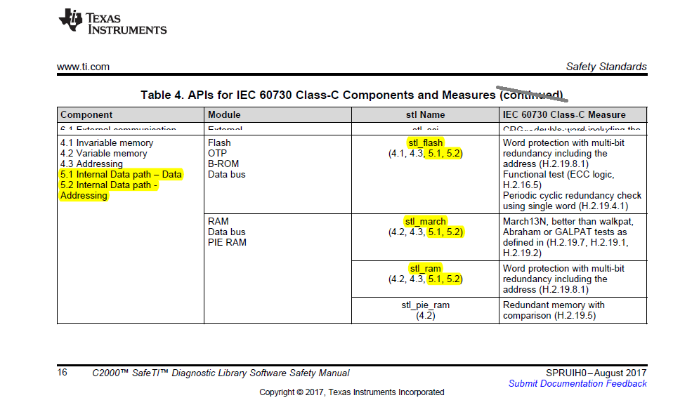

TMS320F28377D: IEC60730 Class-B: Table H.1: 'Internal data path' and 'Internal data address' , where are the target blocks in the F28377D ?
Part Number: TMS320F28377D
Other Parts Discussed in Thread: IEC60730SWPACKAGES
Me and my customer are studying 'IEC60730 Safety library', that is, IEC60730SWPACKAGES   http://www.ti.com/tool/IEC60730SWPACKAGES
I hope you have the spec IEC60730-1, although I don't.
According to my customer, the document has Table H.1, and the table requires some about  'Internal data path' and 'Internal data address'.
Their question is, which functional blocks in the F28377D should be tested for 'Internal data path' and 'Internal data address' ?
Does it make sense and could you please advise?
By the way, they targets Class-B.
    We would wait for your response.
    Please tell me if our question doesn't make sense.
    The HWBIST tests the internal data paths and data addresses, as well as March.
    You can see the SW Safety Manual which is included in the software library for more information.

  • Sal,
    I appreciate your response.
    Can I confirm your reply, do you mean that the HWBIST, or STL_HWBIST_runFull() covers both the {5.1 and 5.2} ?
    I'm looking into the Table-4 in the SW Safety Manual (SPRUIH0.pdf).
    From the table I could not find the relationship between your word "HWBIST" and {5.1 Internal Data path – Data and 5.2 Internal Data path - Addressing}.
    I'm a newbie, so maybe your word would be difficult for me.
    I could understand that the three STLs {stl_flash, stl_march, stl_ram} covers the components {5.1 Internal Data path – Data and 5.2 Internal Data path - Addressing}.
  • Hi Hideaki,
    You are correct. For 5.1 and 5.2, stl_ram, stl_flash, stl_march, and stl_pie_ram are designed to meet the component requirements.
    STL_HWBIST is for component 1, which tests the C28x CPU. I was not sure which type of data path you were referring too.
    Let me know if you have any other questions.
    sal
  • Sal,
    Can we ask TI about simplification from class-C to class-B?
    For example, the part has ECC and parity logics, so it is expected to satisfy the class-B without stl_flash or stl_ram.
    Is it wrong, or up to other implementations?
  • Hideaki,
    You are correct. The APIs in stl_flash and stl_ram are intended to allow customers to inject errors if they desire too, as well as facilitate exercising the ECC/parity logic by performing memory reads.
    sal
