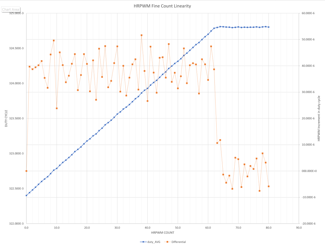

  • Here is some data that was captured showing the issue.  We incremented the HRPWM upper 8 bits of CMPAHR register and measured the duty cycle on a high speed oscilloscope and averaged the waveform.  The orange line is the change in the duty cycle for each increment of the CMPAHR register value.  When the MEP no longer works the differential plot in orange goes to near zero.  As can be observed, the measured duty cycle does NOT increase for a value above 63, even though the condition is valid for the number of MEP steps.  There is some measurement noise, which can be reduced by averaging more samples, but this data using 64 averaged points shows the general trend well enough, that the pulse width isn't increasing even though it is being programmed to do so.
    Lance
  • As an additional point of information, I ported my 28377D code to run on a 28377S micro, and that device produced an MEP_Scalefactor of 69, and it stopped working above a CMPAHR count of 66. It appears that based on testing multiple devices, the nonlinearity occurs 3 counts below the MEP_Scalefactor that the SFO returns. I couldn't find anything in the documentation that would indicate this is the expected operation, but I thought I would share.

  • Hi Hrishi,
    The problem was a bit more complicated than that.  During the tests above autoconv bit was indeed set to 0 but that was on purpose.  If the autoconv=0 and MEP_SCALE_FACTOR = 67, we should see a linear delay response all the way up to 67x256 in the CMPHR register but we were typically seeing that the last few counts (a range of 57-63, depending on the PWM module) did produce additional delay.
    We found the problem to be fixed when we changed the MEP modulation to the rising edge of the CMPA signal (away from the end of the period where it was previously) and the problem fixed itself.  We were attempting to use the HRPWM system right at COMP0 event (we are using the down ramp scheme).  Switching the HRPWM edge to the rising edge meant that we had to invert the polarity of the MEP counts. Unlike the coarse counts, where higher counts mean wider duty cycle, in the HRPWM, higher MEP counts mean narrower duty cycle, so we have add some simple math to take care of that.  We also enabled the autoconv bit to save some computation time.
