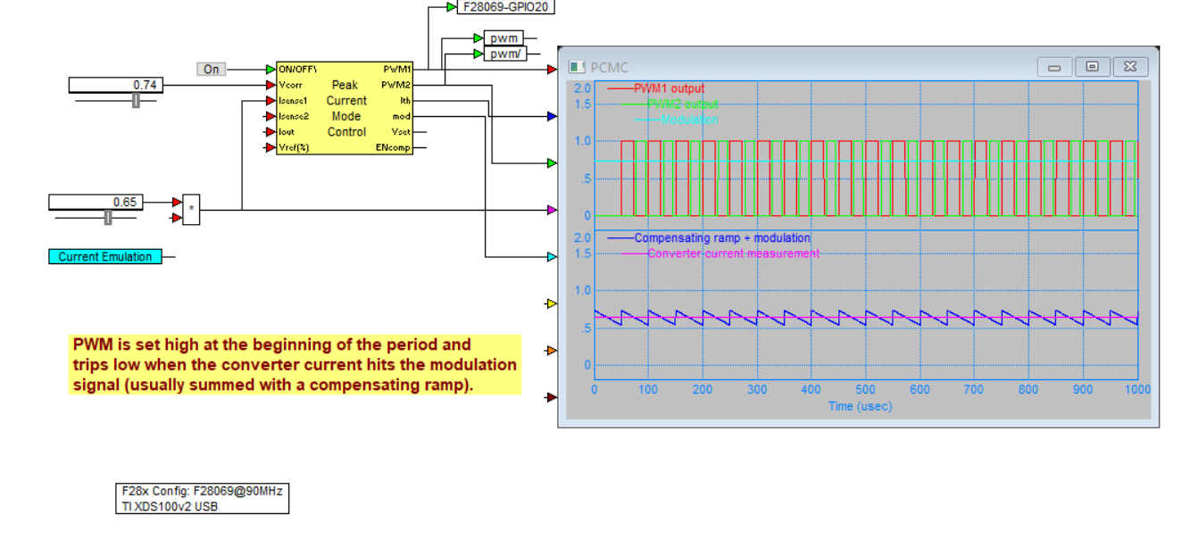

Hello everyone, i'm doing a current programmed mode for my SEPIC converter control. I'd like to know how to do it using the ramp generator and the comparator block of the target.
I tried doing the next code but the signal in the oscilloscope is 100 kHz 99% duty cycle. I'd like to get a 50% duty cycle signal. Thanks for your time

  • Hi Tommy thanks for your reply. I have tried using vissim software and psim software but still cant see a pwm signal using the ramp generator.
    I just want to see a pwm signal just modifying the analog input using the ramp,. something like this picture.
    I would appreciate if you have a code that let me do this.

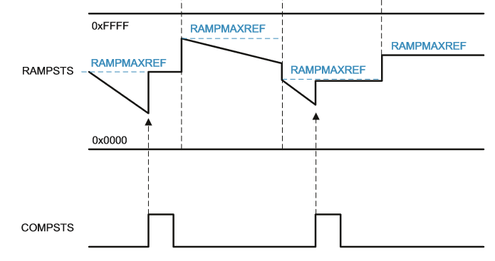

  • Hello tommy, thanks for your help. now i can use the comparator but cant with the ramp, i want to see my pwm signal but is too small with de rampdecvalue and i have used some values but still cant see for example a 0.99 duty cycle pwm signal. Here is my code, can you check it and tell me why i cant see a good pwm in gpio1? thanks:

  • Hello Tommy. I do not know exactly how the DECVAL works so i cant calculate the value i want to use. could you please tell me what DECVAL i have to use if i want a (3.3V)/(10us) slope in the ramp with a period of 10 us? (100 kHz)
  • Daniel,
    The Ramp Generator is documented in the TRM.  It would probably be best for you to work out the details of how to configure it for your particular system because you will most likely need to optimize the settings after the first pass.  In a nutshell, the RAMPSTS register is initialized with RAMPMAXREF and is decremented by RAMPDECVAL on every clock  cycle until a RESET event is generated.
    -Tommy
  • Yes Tommy, know i see what my error is. The RAMPSTS is RAMPMAXREF again when the DAC is equal to RAMPSTS. I want a signal which value is high before RAMPSTS is greater than DAC and LOW after RAMPSTS is lower than DAC (after the cmparation).
    Cul you help me? i think is with a trigger
  • Daniel,
    I'm not following your question. The DAC value is sourced directly from RAMPSTS.
    -Tommy
  • Tommy the problem is that  RAMPSTS goes high when the reference is higher than the ramp and COMPSTS is just a pulse signal. I want a Pwm in low after the first time they cross. In short words. I want COMPSTS high when the ramp is higher and  COMPSTS low after they cross in time.
    I have tried to do this for weeks but the ramp generator is crazy when it compares
  • Daniel,
    The Ramp Generator was designed to follow a very specific state machine behavior (including the trip response) for PCMC applications and is not able to deviate much from it. I think you might be more successful by not using the Ramp Generator.
    Would you be able to use the CPU or CLA to periodically update the DAC value to generate your own custom ramp and then use the COMPCTL[CMPINV] bit to invert the comparator output to meet your desired behavior?
    -Tommy
