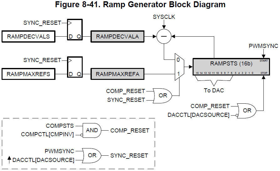

I am trying to implement a ramp generator ( saw tooth type) using the DAC sub-module for peak current mode DC converter slope compensation, based on the info discussed in this app note:
http://www.ti.com/lit/an/sprabe7a/sprabe7a.pdf
I have written the code, but I  need to test it. Can anyone tell me how to view the ramp on the scope or on the emulator( I know there is a feature for graphing data while in debug mode).
I need to make sure that the ramp starts as soon as PWM1 goes high and keep decreasing by the slope value I set till it gets to zero by the end of each PWM cycle.
Thank you!

    I tried verifying that my ramp is working properly. With the scope I was looking at COMP1OUT while I am changing input voltage on the non-inverting pin of comparator1. I set Comp1Regs.RAMPMAXREF_SHDW= 65472 ( I assume this corresponds to 3.3V) , and Comp1Regs.RAMPDECVAL_SHDW = 20;
    I kept changing the DC voltage for Comp1A pin. I was able to notice that the PWMA duty cycle keeps increasing as I decrease the DC voltage., but COMP1OUT output stays low. The only time COMP1OUT goes high is when my DC input at Comp1A pin is around 3.3V which is the value I set for RAMPMAXREF_SHDW.
    I was expecting to see the output of COMP1OUT toggles PWM every cycle( based on the DC input voltage at Comp1A , so that I can measure /verify the slope of my ramp.
    Can anyone tells me why this is happening. Thank you!

  • farid,
    The analog comparator operates independently of the EPWM so its trip status (COMP1OUT) will not be affected by EPWM cycle boundaries.
    In your initialization code, the comparator output is configured to be a cycle-by-cycle trip source, which means that the trip status will self-clear at the beginning of each EPWM cycle.
    I believe that you are seeing the comparator output a constant trip when V+ > 0.9V. At the beginning of each EPWM cycle, the CBC trip is cleared, which allows the EPWM1A output to be active until the comparator trip is qualified by the DC submodule, which then asserts the CBC trip for the remainder of the EPWM cycle. Depending on your PRD, this could look like a 5% duty cycle.
    -Tommy

  • farid,
    Correct, the COMP1OUT output will only change when V+ and V- cross each other.
    I have not done this myself, but you should be able to read back the values of RAMPSTS and DACVAL using the CPU while the ramp generator is decrementing.  So if you want to prove the ramp generator behavior, you can set an EPWM CMP interrupt a few cycles before the end of a cycle and then use a CPU loop in the ISR to store a buffer of TBCTR vs RAMPSTS vs DACVAL values so that you can trace the sequence of events offline.
    To calculate the RAMPDECVAL, you would probably want to determine the desired slope in mV/us terms first.  The 10b DAC would give you an LSB step of VDDA/2^10, so about 3.2mV per step.  The ramp generator decrements at SYSCLK so you would have one decrement operation about every 11.1ns with a 90MHz SYSCLK.
    -Tommy

    When I set: Comp1Regs.RAMPDECVAL_SHDW = 20; This value of 20 does it get subtracted each clock cycle from the 10 bits DAC value representing the peak value of the ramp(Vpp), or from the scaled value of the ramp( VPP*64)?
  • Farid,
    The value of RAMPDECVAL is subtracted from RAMPSTS every clock cycle.  Only the upper 10-bits of the RAMPSTS register are mapped to the DACVAL register.
    From the TRM:
    -Tommy
