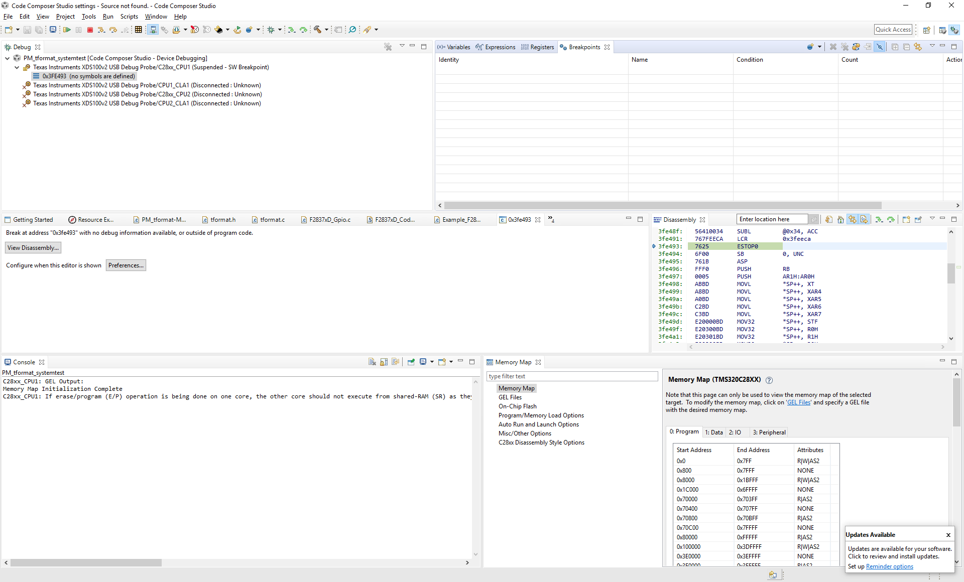

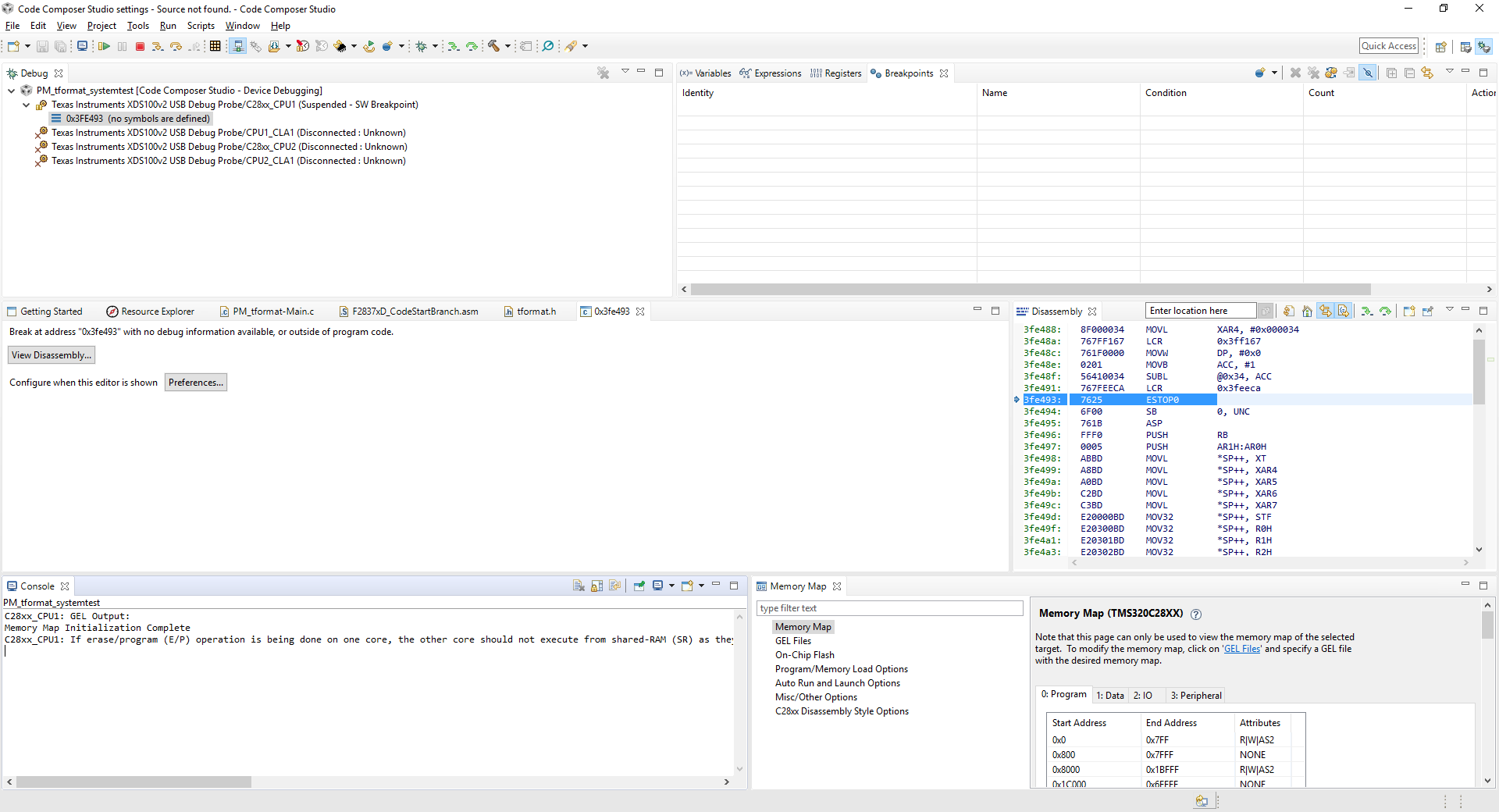

  • Hi Subrahmanya, I have removed the booster board and tried debugging the code. The code appears to go straight to an 'ESTOP' command (presumably an exception?). I have restarted the code using the 'restart' and 'reset cpu' buttons, but end up in the same place. In the disassembly window, the code is shown to be at location 3fe493. Please see attached screenshot.

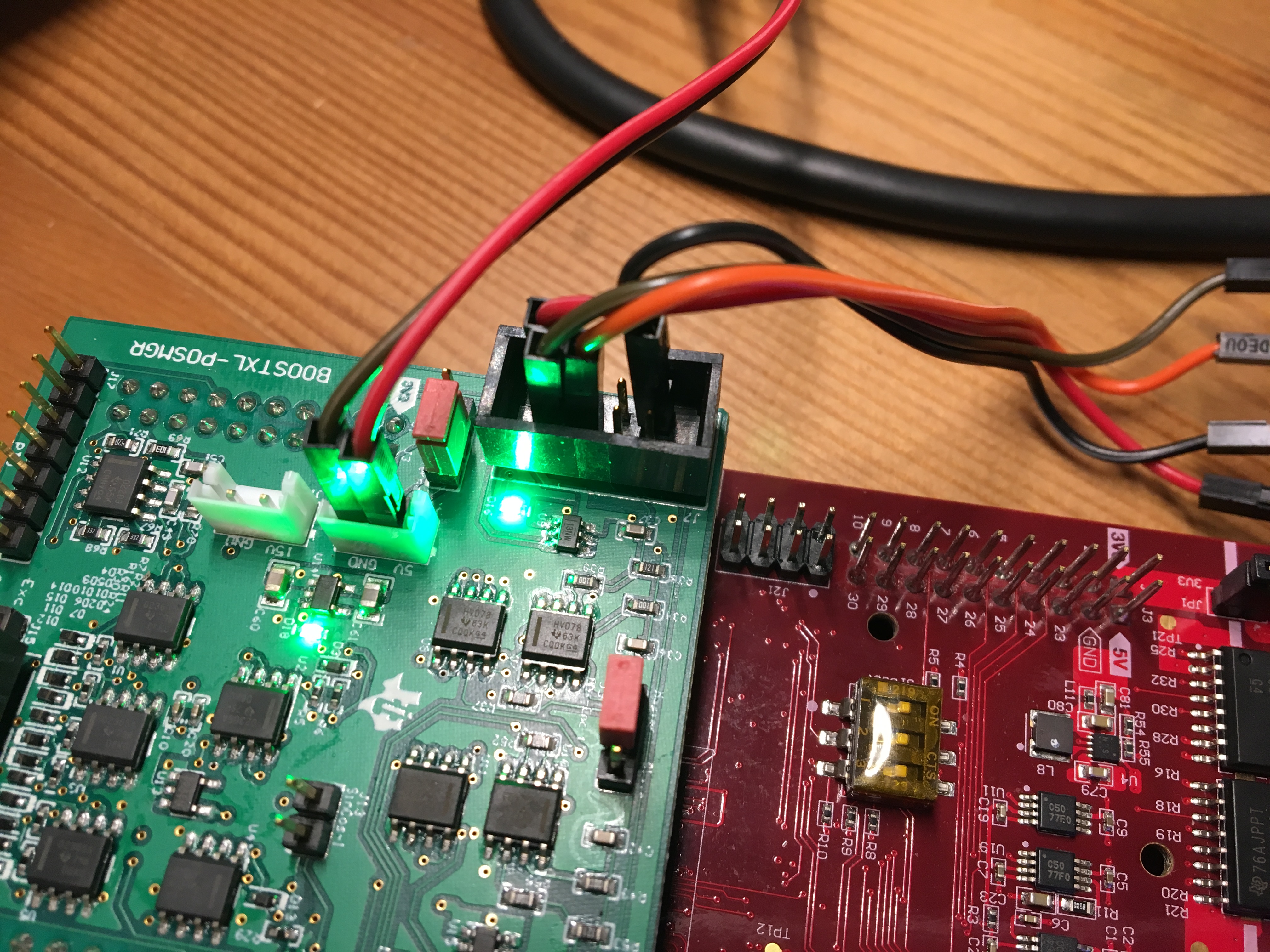

  • I have now connected in the boostxl-posmgr board. D18 (power) is on and now with the code running D16 (encoder 5V) is on as well.
    Unfortunately the expressions in the window are not updating with new values (just staying at 0) when the code is running and turning the encoder. The code is still pausing at the same line of code as before (150 of tformat.c) and waiting for data to be ready.
    Do you have any more suggestions?
    Please see below for my connection details
    Pin No.Function     Wire colour from board      Wire colour Tamagawa TS5700N8401
    1                 GND             Black                                           Black
    6                 Data+          Orange                                       Blue
    7                 +5V               Red                                              Red
    8                 Data-           Brown                                        Blue/Black
    N/C            Batt+           N/C                                              Brown
    N/C            GND             N/C                                              Brown/Black
    J5 set to external
    J9 set to master

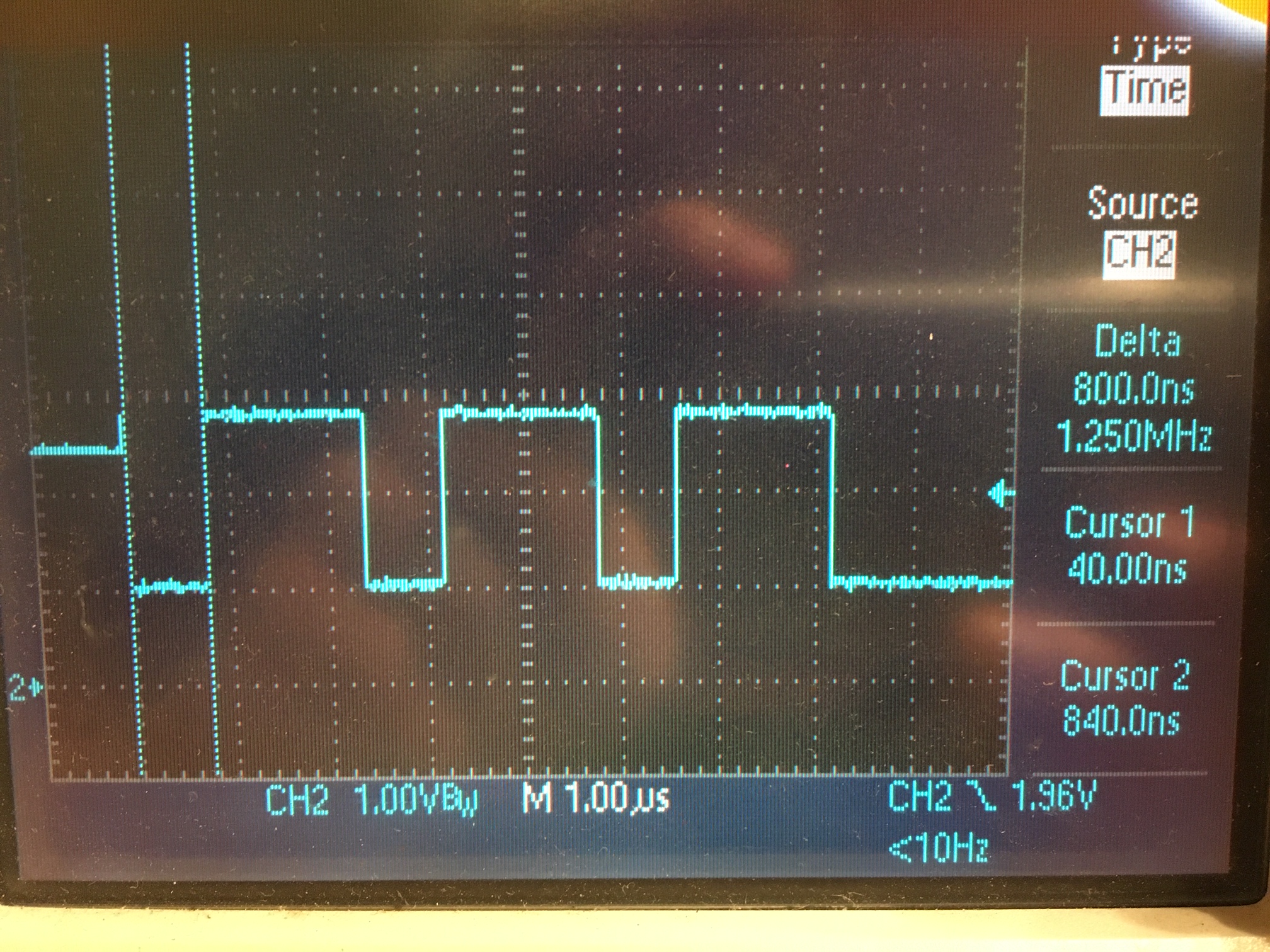

  • I can see some movement on the data lines now. I have to stop the debug session and then restart the debug session again, using the restart button does not have the same effect. When I run, a sequence is present on the data lines. The total length is exactly 7200nS. This is 18 bits long based on a width of 400nS? The smallest width I observe is exactly 800nS. Perhaps I am actually observing 9 bits, that are 2x too long? And the clock is out by a factor of 2?

  • That's great! I'm not sure what exactly is wrong in your development environment that requires restarting your debug session.
    Yes - looks like the bit width is 800ns. It has to be 400ns.
    One option is you can double the clock (PLL multiplier) -
    Inside F2837xD_SysCtrl.c, you can change InitSysPll function with IMULT_40 (if the code has IMULT_20).
    I think, it should work with this change - since you've already observing the right signals.
    Encoder will not respond unless the data rate is 400ns.
